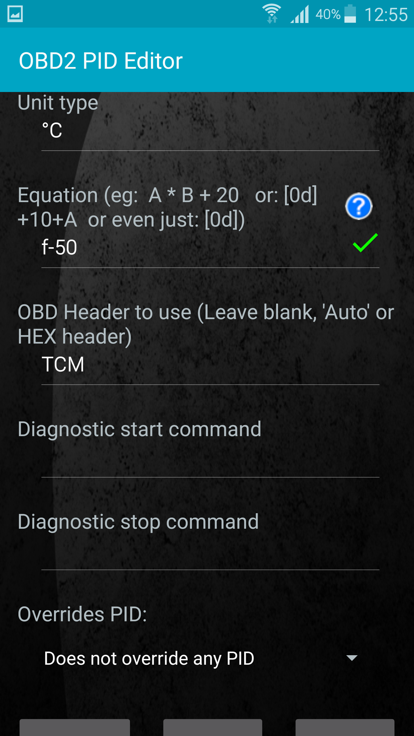

My coolant temp stays around 90 C, but I find the pid formula for the auto box indicates around 85 C, climbing to 95 C on steeper inclines. I think the pid may be wrong (should maybe be f-40 instead of f-50)...

Cats, attached are 2 screenshots for the auto box temp - the one I think overstates the gearbox temp.CATS wrote:Have you guys managed to do a screenshot? There is a button for that on Torque but I cant seem to get mine to work, or I just dont know where to find the file. If one could easily do a screenshot and share that will make it so much easier.

My pid is on the f50 setting as posted earlier by myself and it seems to be working 100%. Ussualy box is about 20degC cooler than engine but working hard and towing definately increase the gearbox temp, so I think mine is working fine. I have not seen any setting to see gear selected.
