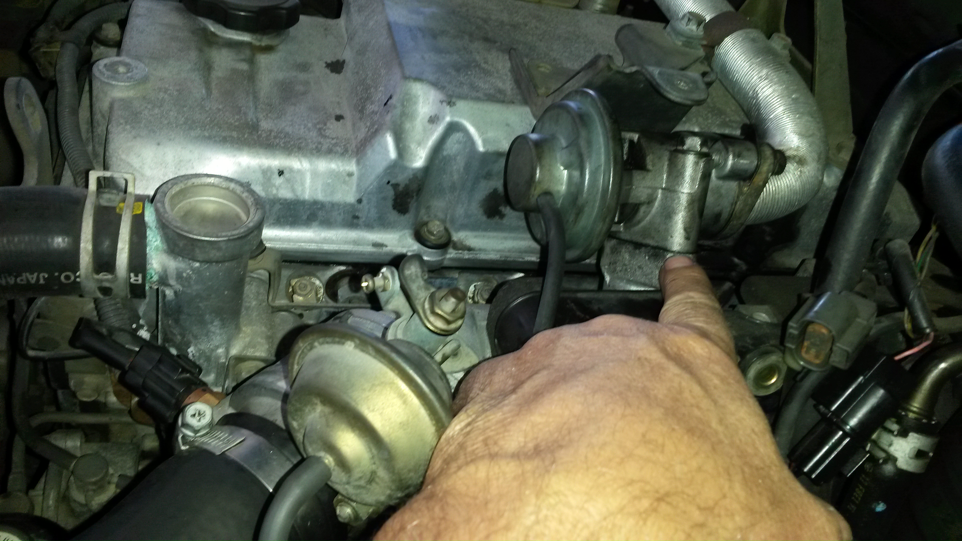

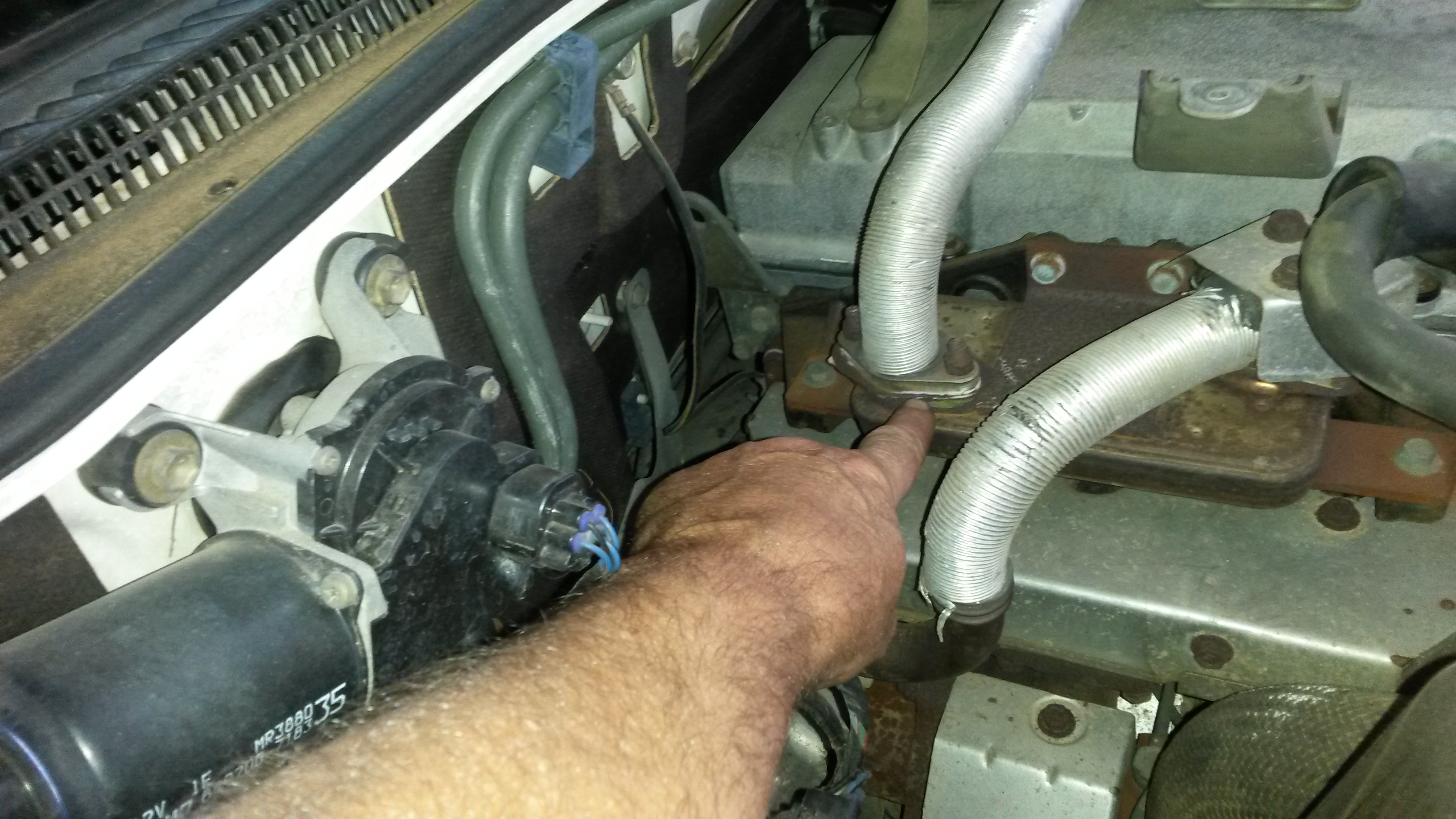

Howzit guys. No I would not mind Cats. A good deed is a good deed! Have you put yours in yet?
Here is how I do it. I make a template and I cut the blanking plates from thin galvanised sheet with tinsnips. I use the gasket from the flange as a template. It helps to drill the holes first otherwise if the drill bit snags it will either cut your hands to bits or destroy the plate you cut to size. So obviously it is the same size and shape, bolt holes etc as the gasket except the middle hole is not cut out.
The pictures are from a Gen3 we have in the workshop. You can fit a plate before the EGR valve or after or both. The Gen4 EGR system is water cooled so I prefer blanking both sides on Gen4 simply as a safety measure.
