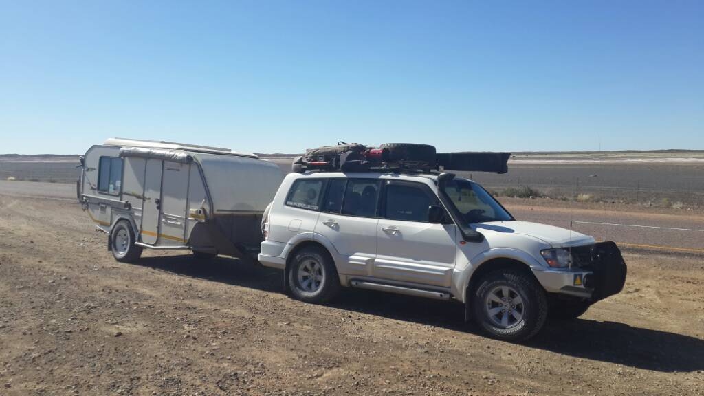

IT FAILED SPECTACULARLY!
With a spare and two Alluminium bridging ladders on the rack I done about 2000km of bad dirt roads, not off road, just dirt roads before the front support started to tear my roof open! Well I should have known better with that overhang....
Had to strip it down again, remove the look alike brackets and this time fix the damage before reinforcing my roof and fitting a set of Front Runner rails.
My opinion, and that of my wallet, it's not worth the effort at all. Go full length tracks or don't fit a rack at all.

My roof rack with the solid ally supports (6) plus metal inserts in the front and rear supports have been all over. We toured Kaokoland and Damaraland plus Van Zyls pass plus crossing the Hartman mountains and STILL no problem either to the roof or the supports or the roof rack. During the Kaokoland/Damaraland and the rest I started of with the following on the roof rack:
Howling moon tent
100 litre additional fuel in a metel tank
A steel bin with chairs, stretchers and gas braai equipment in it.
Plus a wire nesh bin with braai wood.
Maybe I am lucky or my design is good.

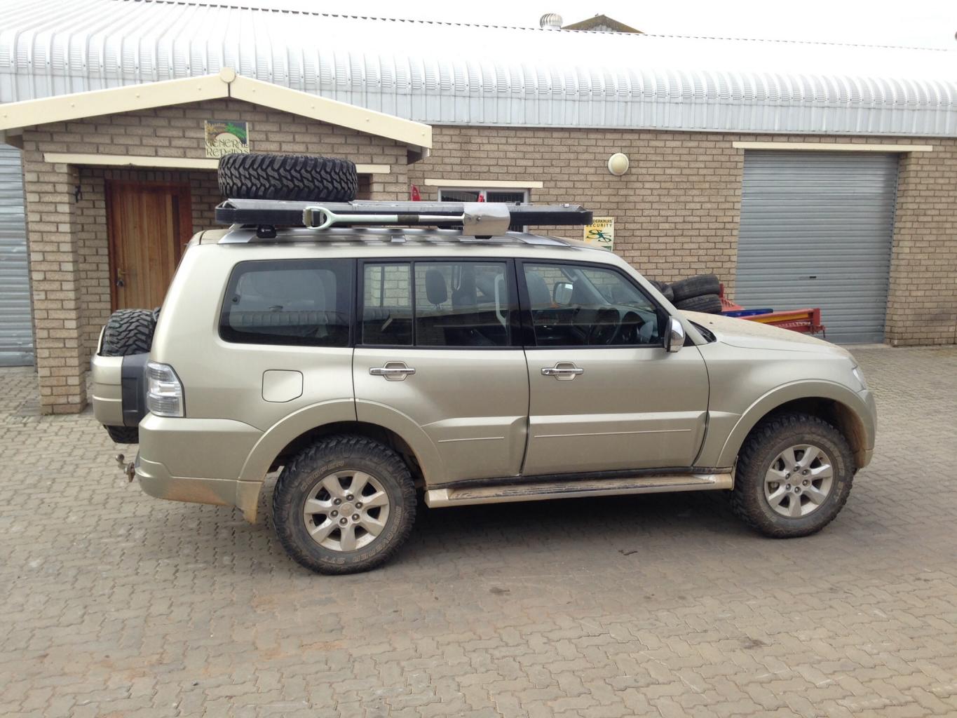

I recently fitted a Frontrunner roofrack on my 2013 SWB Pajero. The standard rails can support max 100 kg. I chose to go for the option of the removable roofrack as I plan to carry only jerrycans, spade and gasbottel and 1 or 2 ammo boxes with no heavy stuff packed in them. The reason for for this is to remove the rack to save on fuel cosumption when not needed. I have just completed a trip through Botswana, Moremi and Caprivi without any hassles. The guys at Frontrunner in Midrand near Kyalami were very helpfull. Frontrunner has developed a new permanent bracket which they were willing to do on my Pajero, using it as a prototype for future brackets as they did not yet made one for the SWB. All I had to do, is leave my car at their factory for a few days. They were willing to make the brackets free of charge, using my Pajero as prototype.
