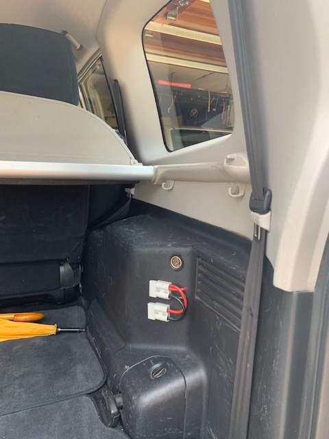

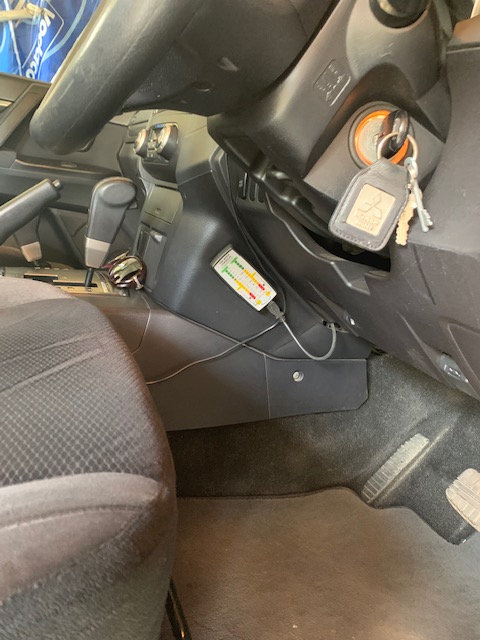

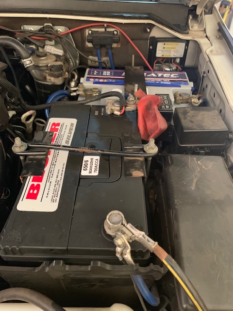

Hi Matt, due to the space restriction in the Pajero's engine compartment, one can fit only a 80AH Battery(Deep Cycle).
Some might say it is too small, but for me the trade-off is that I am willing to live with the Powers supply limitation and do not want to sacrifice my loading space.
I make use of a 40l Engel Fridge and the 80AH is more than sufficient for me.
For me, the installation in the engine compartment is also an "install and forget" scenario as the installation in your load bin is always "in your face" that must always be taken into account when loading, cleaning etc. With the battery in the load bin you will also NOT been able to use the 3rd row seats(which I use occasionally with my grand children). However, for some this might not be an issue. This choice is yours.
One can swap the 2 Batteries to use the "Standard" Battery, a 90AH Battery, as the "dual" Battery and Visa Versa.
Attached is a few pics.
Happy 4x4-ing
