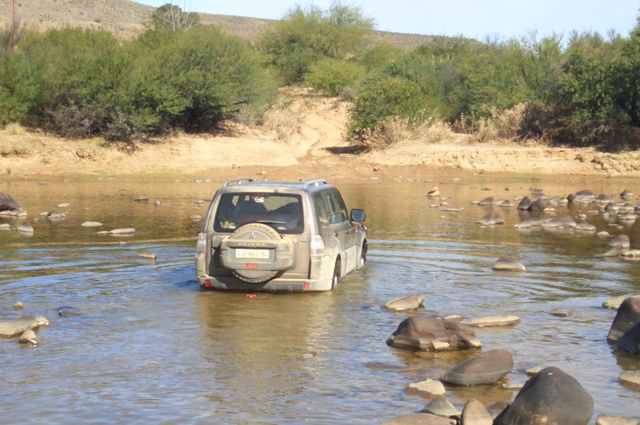

RoelfleRoux wrote:and a wash :o
Roelfie, I did bath her but she likes her dust........
