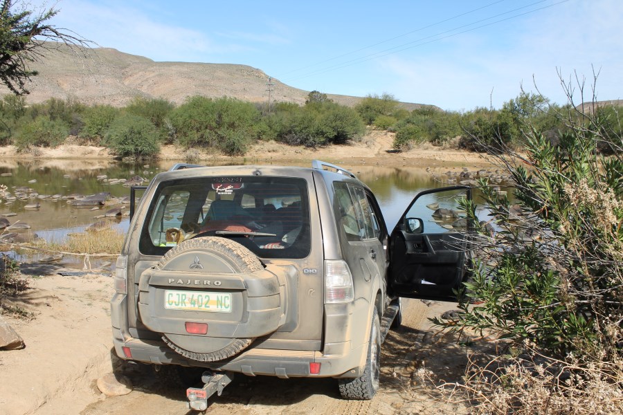

My gen 4 got the looong towbar. Its bothering me a bit when I hitch my explorer.
When I pack my explorer I try not to put to much weight in front of the axles and also full up the water tank for more weight in the back. I am no weightlifter with ma se muscles and can only lift the explorer 1mm for 1 second. Its a heavy caravan.
Now with the long hitch it means the weight on the towbar is greater than with normal towbars closer to the body. However the pajero tows like a dream and is very stable.
The long towbar is fairly low and its very easy to tickle the caravan's nose when going over a speed bump. That's really not acceptable for me. It's an offroad rig.
How do you guys experience your loong towbars with your Gen4's? Do I need to worry?

The towbar seem to have one setting only.I think its the ultra long one.
See pic.
See pic.

Yes, you can move the ball up, but you aint gonna achieve much.
You'll still have the loooong towbar.
Just shorten it. M2CW
