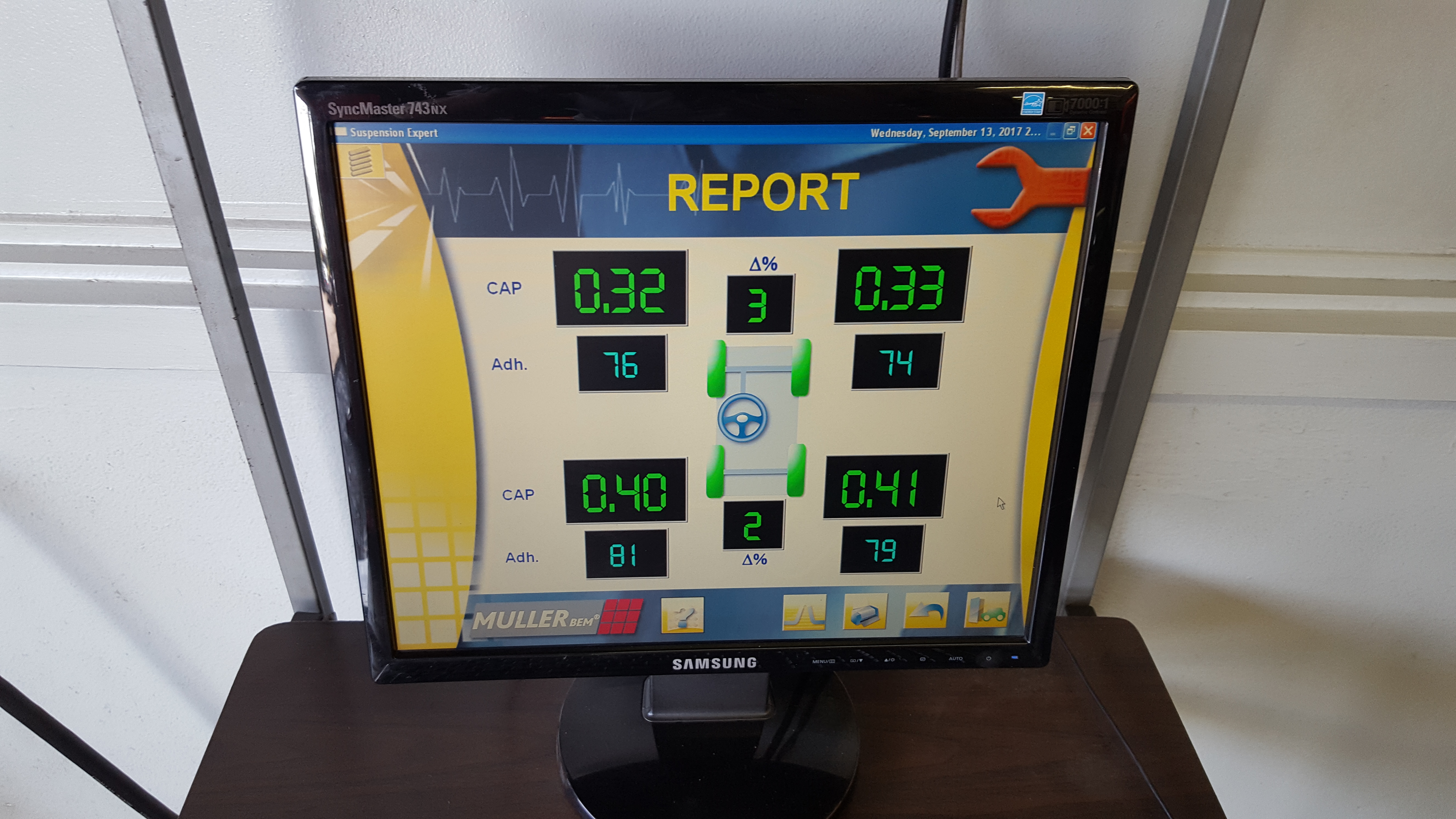

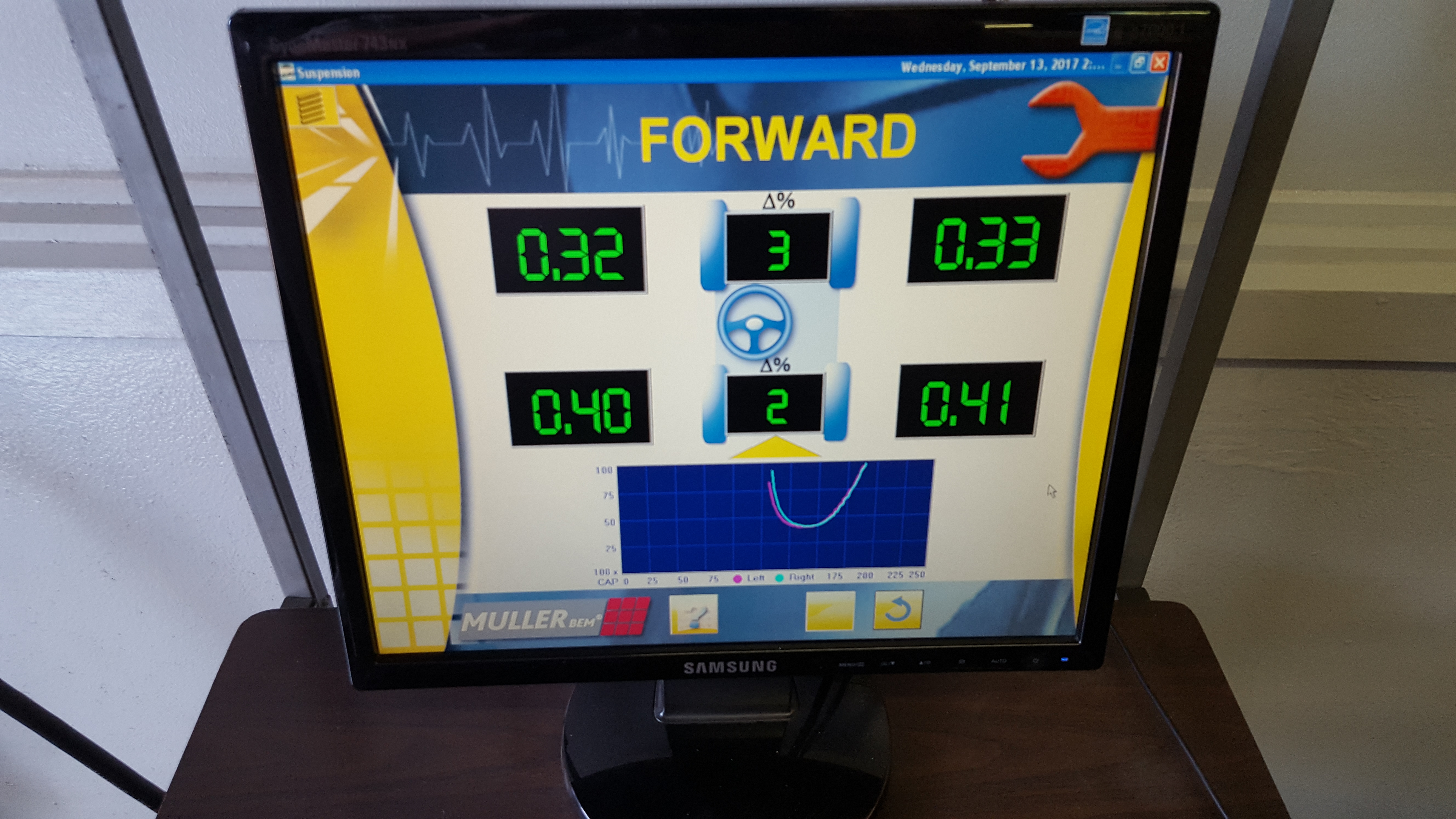

I had the shocks tested on a Gabriel shock tester and the dealer said they are fine. Can anyone explain the numbers on the attached pictures.
Shock Absorber test results and hard ride on small bumps

Any comments on the shock absorber graphs?
