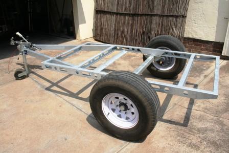

I spend most of my time in Africa. I visit the Mines in Africa and assist them with the processes on the Plants. I decided in February this year I am going to build this caravan I have been designing for the past two years.
Decision was made and I got myself all sight up and started with it. I only work on it one weekend a month when I am in the country and some times during the week in the evenings I will also scratch here and there. It is really very seldom that I spend more than two weeks a month in SA.
But yea, you can see there is progress although a bit slow, but I am getting there. I hope to use it for my trip to the Manapools in December.

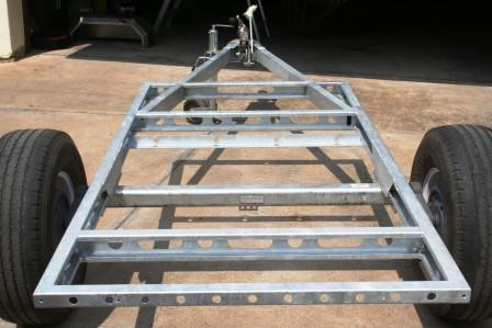

Just an update. I have received the chassis back from the galvanizers. The nice thing now is that now what you put on is complete and no more put and take off.

I ordered a what they call a Rub-Axe. Commonly use on Caravans. I just went up on the loading capacity of the axel to 1,8 Tonnes. The axel has its own mounting bracket which i Just bolt on to my Chassis with 8 off M16 x 30mm 8,8 Bolts, Nylock nuts and washers.
