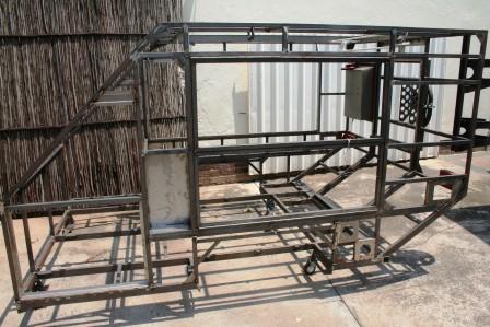

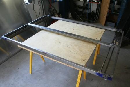

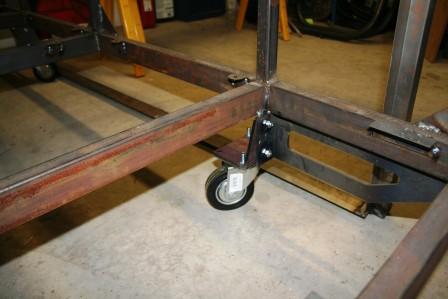

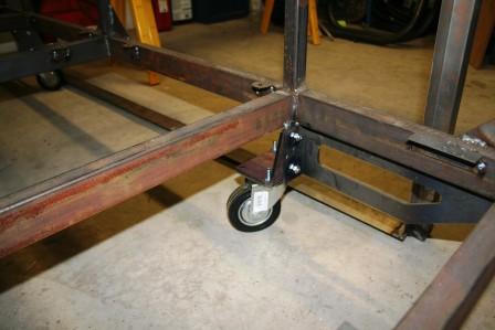

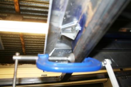

Hi Guys
Just an update. I finished the support frame for the pop up roof this weekend and the brackets for the gas shocks. I also decided to make some brackets with some castor wheels and bolt that to the caravan to enable me to move it around. Sometimes it just too difficult to get gyus together to assist to carry it around
