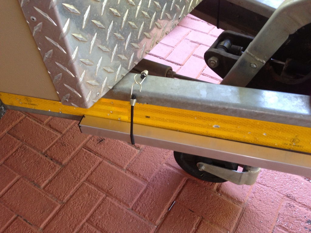

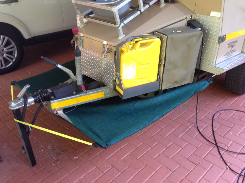

It is always lekker to see what others have done to their rigs. I have a few mods that I will post here as soon as I find my pics, but thought this an awesome idea as posted on the 4x4community site to prevent the stone rash to your trailer, simple and easy to do. I have opted for the coolloaroo material as you find at Builders warehouse that they use for the funky shade awnings as it is nice and thick, just need to get cracking and do the rest.
Post some of your mods done or seen elsewhere to trailers and caravans

What is the purpose of the "shadecloth" scoop? Not a caravaner myself, but do have a Venter trailer.....

Are you going to have those swing arms "spring loaded" by some means to enable them to give way when you make a turn?
My Xplorer came with these nifty Stone Protectors fitted at an angle to allow the rig to turn wihout problems.

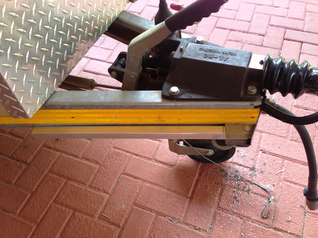

Purpose is to prevent stone rash from off road and dirt road travelling to prevent rocks being thrown up onto the trailer, bouncing onto the rear door and breaking rear window. There is a yellow bungy cord which is seen in the 2nd and 3rd pic as they are displayed, which go around the towbar so when you turn it will give way.
Lowrange, your idea is also cool, thanks for sharing.
I may do a combination, have already added longer mudflaps.
