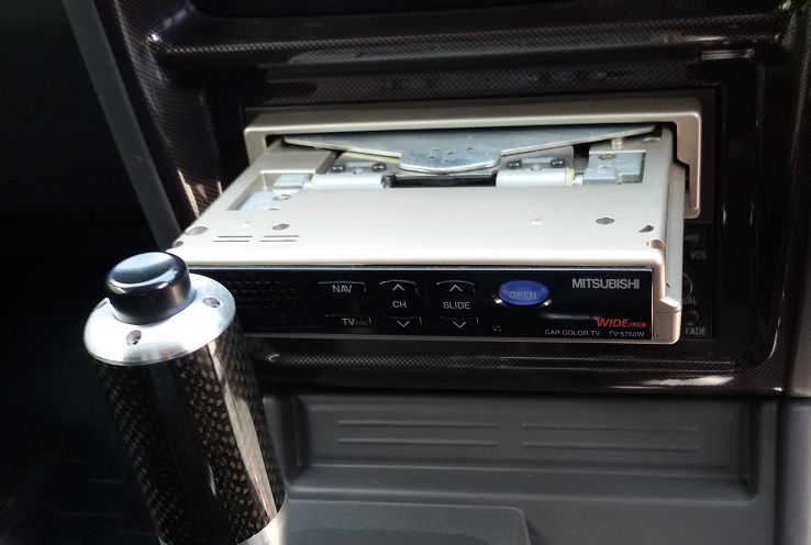

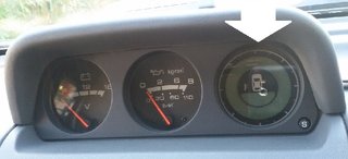

1st question : I'm from France and have a "little problem" with the TV on the dashboard (Evo received from Japan lats week)
Can you explain to me how i must use it ?
The screen comes out of the dashboard but did not fall . . .
Any solution ?

I'm also French (but live in South Africa) and although I don't own an Evo, I'll try to answer your questions. We can speak French via PM if you find it easier
1. I'm not sure about this one. I imagine that the "slide" button is for on screen navigation, and not to tilt the screen up and down? Have you tried to push those buttons?
And what happens if you try to tilt the screen up by hand? Is it stuck?

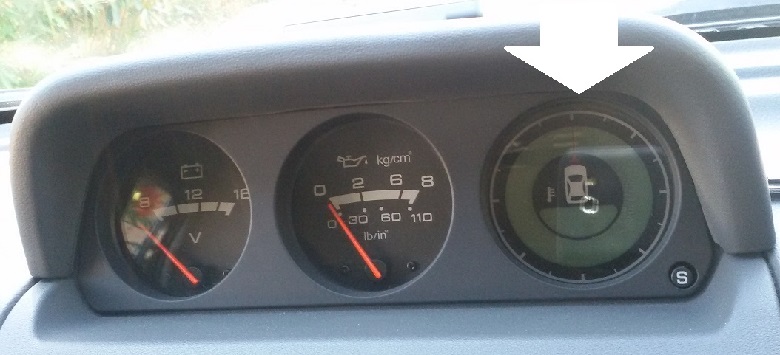

2. This is a compass (boussole) and needs to be set up. Press and hold the round button with a "S" on it at the bottom right. A "S" should flash and go around in circles on the gauge. You need to drive the car slowly in a circle. This is for the car to learn where North is and to calibrate itself. You can/need to set your magnetic deviation too, I don't remember exactly how to do this, maybe it was by pushing "S" once more after it was calibrated? Maybe others here will have a fresher memory than myself (I sold mine a while ago).
You need to do this everytime you unplug the battery.
And in the half circle under the car drawing is the outside temperature.

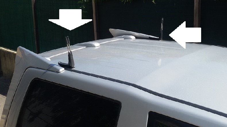

3. Again, not sure about the Evos, my first thought was that it could be the radio antennas, but you have it on the A pillar on the passenger side. Maybe the TV antenna then? I haven't seen it on the pictures of the other Evos posted here, but maybe TV was an option that the other ones here didn't have.
I hope this helps!

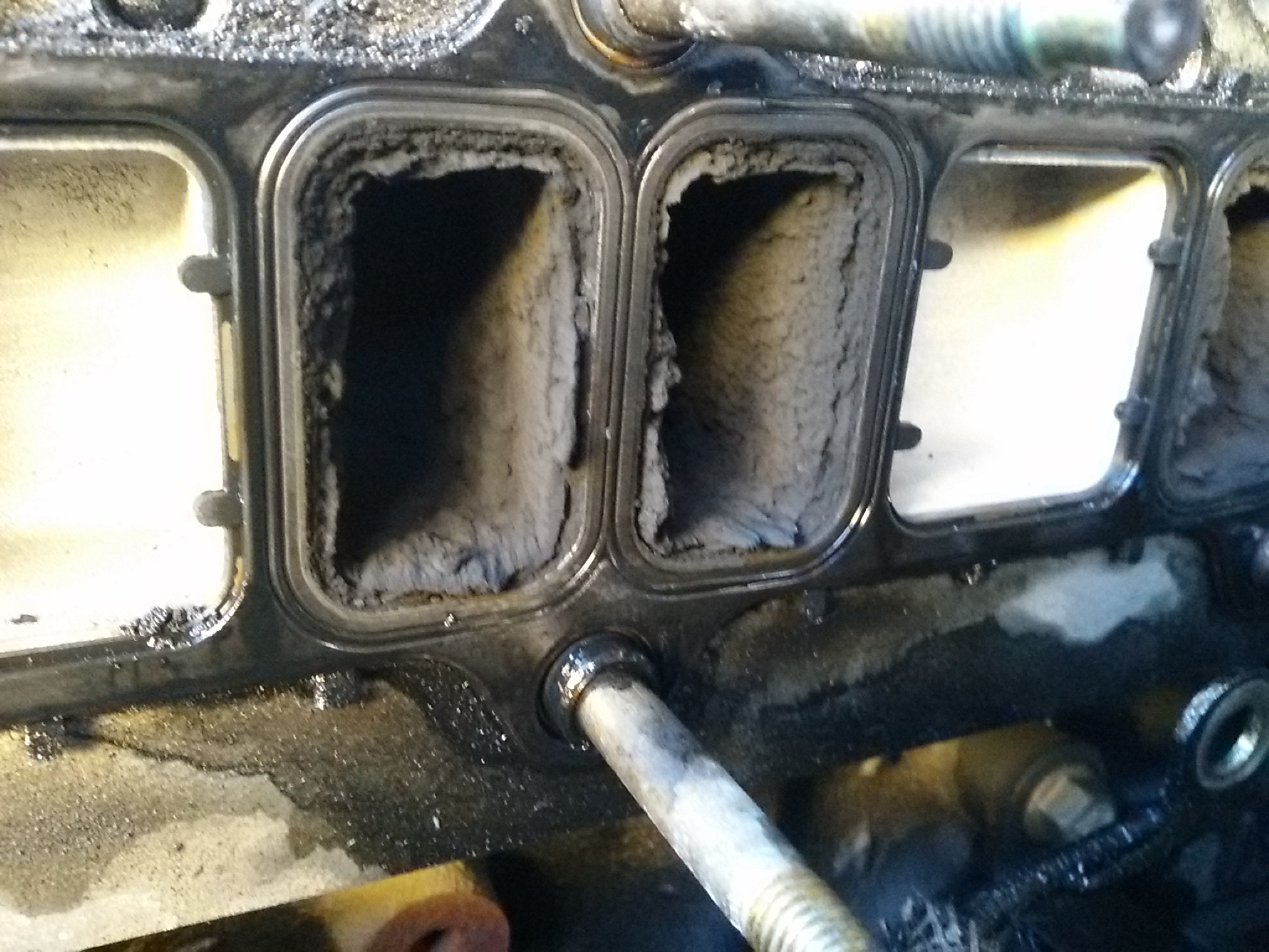

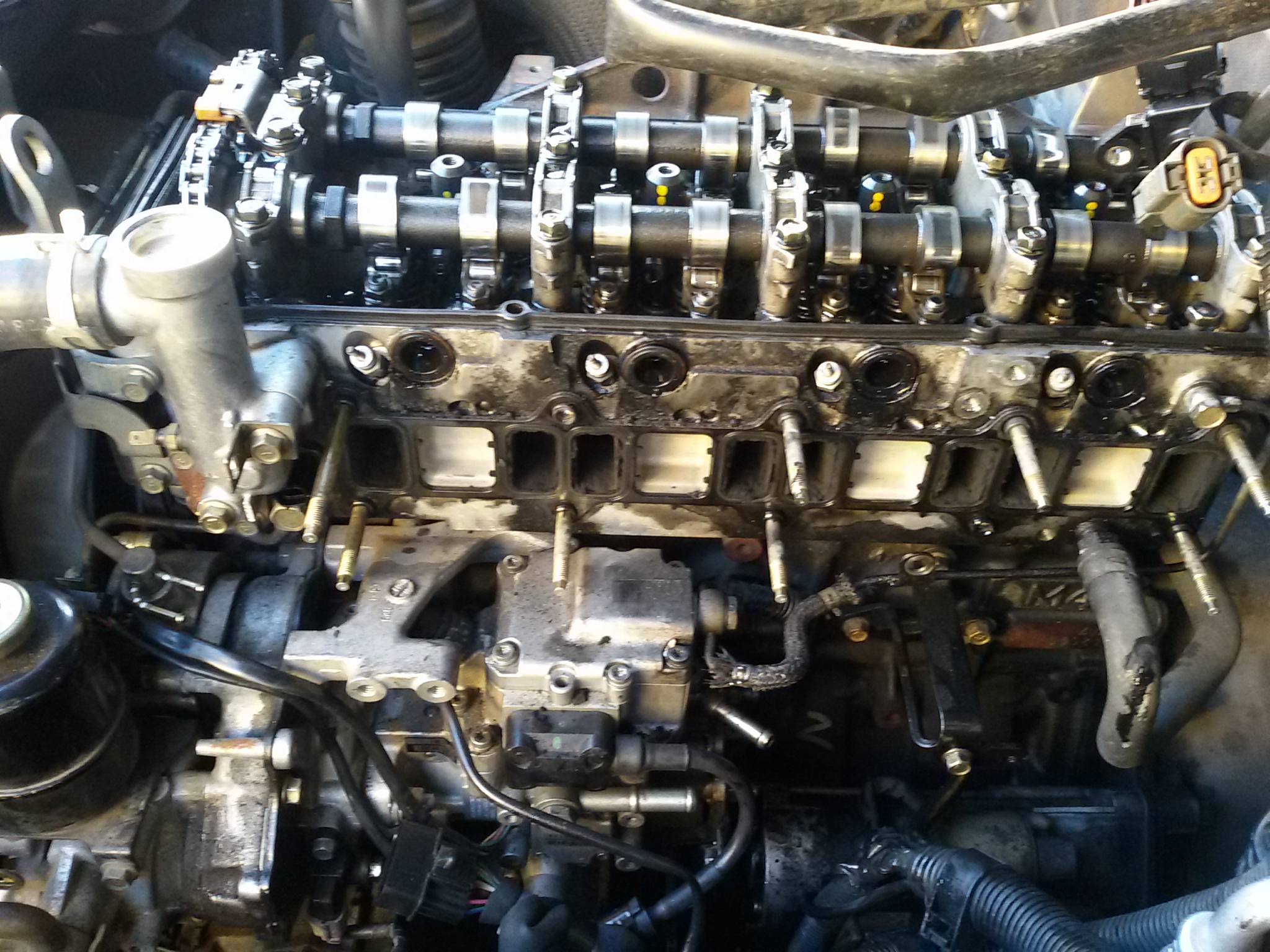

* J'en ai acheté un autre (3.2 Di-D / 2000 / 193.000kms) avec "défaut Pompe injection" . . . à pas cher (le proprio en avait ras le Q d'y injecter du fric.
- Démarrage OK
- Ralenti OK
- Impossible de monter dans les tours ! Dès qu'on accélère le moteur cogne et broute et fait une fumée noire de locomotive à charbon.
C'est parait-il, la maladie du 3.2 DI-D : limaille de pompe + intérieur du réservoir qui se dégrade . . . l'un entraine l'autre.
Je démonte et vais jusqu'à la pompe, on verra bien, ça m'occupe.

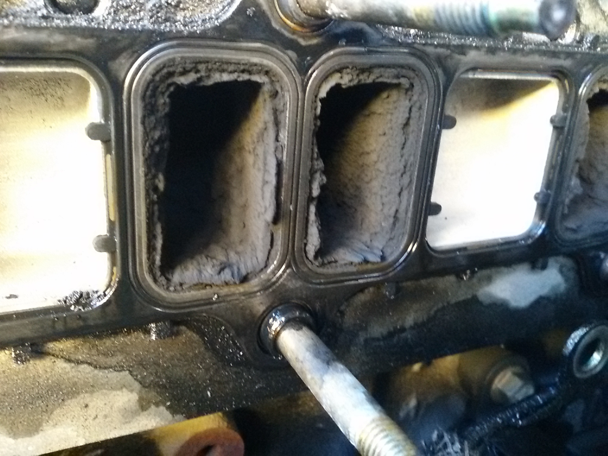

MERCI encore.
