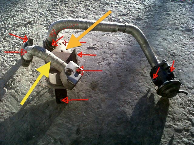

I am considering a EGR blank of, but I am still unsure how and where it should be done. I am also concerned about he effect - reading a lot of opposing views.
Also why are some people drilling holes? see http://www2.pajeroclub.com.au/forum/sho ... 727&page=2
I am also unclear if the pipe with the yellow arrow and the "box" with the yellow arrow should be removed. It look like the part with the yellow orange arrow is attached to the watersystem piping?
