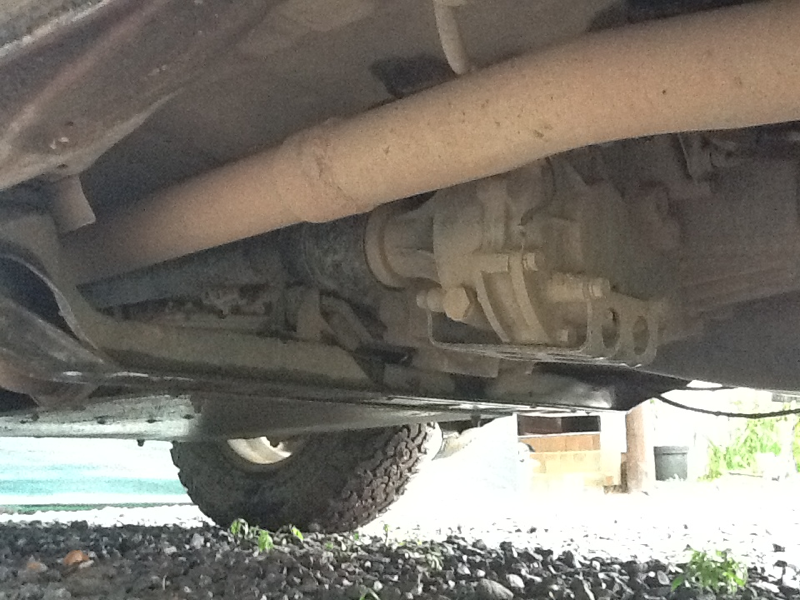

I just replaced with a straight pipe.
[ATTACH]5433[/ATTACH]
