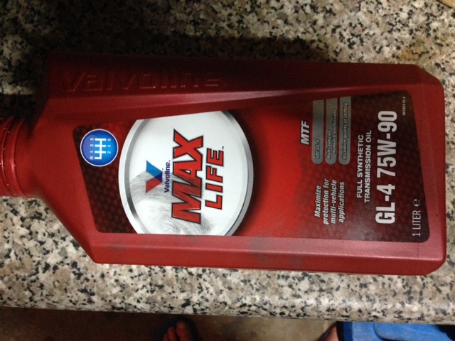

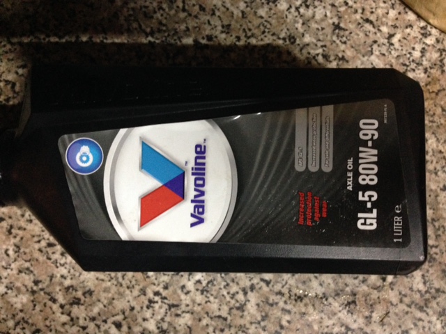

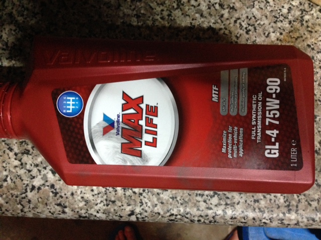

Valvoline GL-5 80W-90 : Differentials
Valvoline GL-4 75W-90 Fully synthetic : Transfer case (manufacturer's spec is GL-4 75W-85)

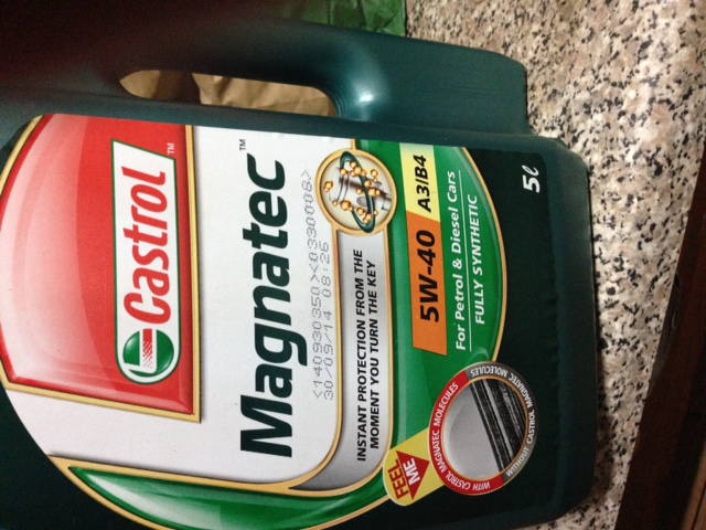

Castrol Magnatec 5W-40 Fully synthetic : Engine
I still need to do the auto transmission and will use DiaQueen as specified by the manufacturer.

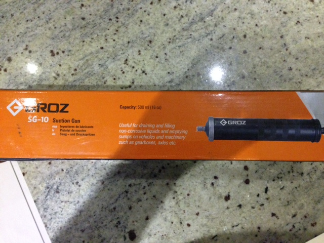

I purchased a GROZ SG-10 suction gun from Highveld Garage Equipment in Montana, Pretoria, as it took forever to change the diffs and transfer case oils. (Squeezing those bottles to get the oil out with a plastic tube attached is a pain to say the least). I have not used the gun but hope it will be of help in the future.
Any views on my choice of lubricants?
