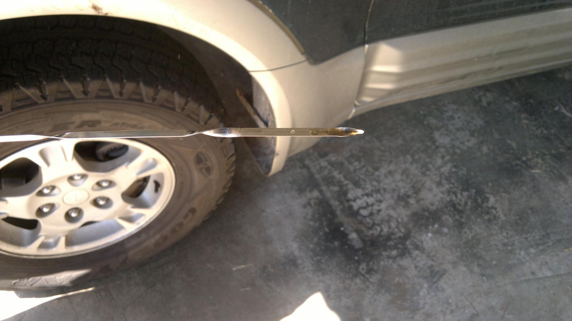

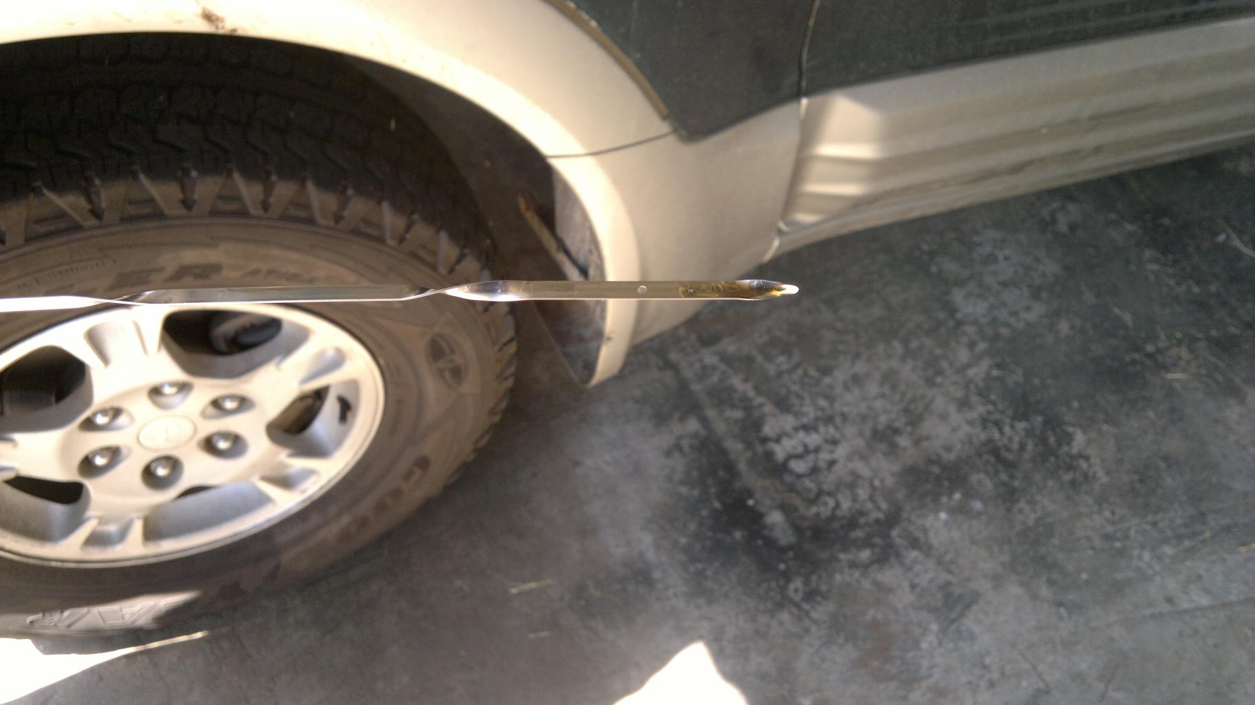

Been thinking the same thing as it was only the red that came on. Maybe i didnt give the light enough time to come on.
Just there next to the road i checked the oil level on the dipstick and the level showed still about 10mm on the bottom of the dipstick.
These 2001 Di-d we have got those wire type dipsticks but mine was bend and the wire started fraying so i have it replace and got one of those metal type dipsticks now
The Picture is one i took 2weeks back after the oil change and not next to the road after the oil sensor failure
