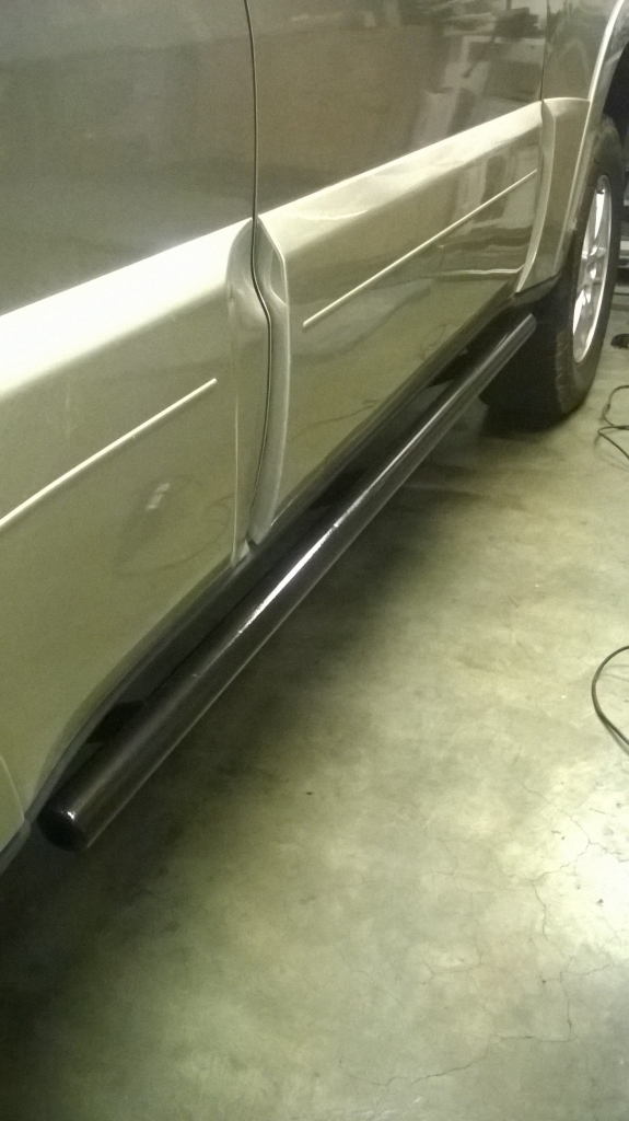

Home made rocksliders added, left side to be completed this weekend. Im happy with the result, very neat and discreet. The actual slider is a 75/50/3.5 tube right under the chassis at about the same height as the diesel tank protector and the round tube is 50x3.0 just to protect the bodywork on side slopes etc. Also useful for standing on to get access to the roof when the roofrack is on.

gerbek1 wrote:Home made rocksliders added...
Looks very neat - not going to add high lift points?
I don't own one so why would I need it? And besides, the Paj won't get stuck [WINKING FACE]. Also not sure they are strong enough, to be honest.
That is what I was thinking. Decent rock sliders need to have enough strength to hold the weight of the car loaded
The slider part is definitely strong enough to hold 3x the weight of the car at a point midway between the brackets. I calculated the flex to be less than 5mm (I'm an engineer). The tubes on the outside are more cosmetic and the slider part is too far under the car for a hi-lift jack to reach.
