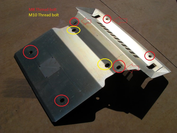

Could not find the issue, all was within spec with no play what-so-ever... Refitted my LYNX bash plate and the noise was gone!
Drove for a day or two and it slowly re-appeared again, I was very frustrated at this point. I had a sneaky suspicion and I removed my bash-plate completely for a day or two. Noise gone again!
The bash-plate was the culprit, creaking against the chassis...
Upon closer inspection, I found three partially stripped M8 x 1.25mm threaded captive nuts (in the chassis) that are used to fix the bash-plate to the chassis with bolts. The thread would take just enough to hold the plate when fitting but slowly work loose again when driving, with the chassis twisting slightly over the road. It uses six M8 and two M10 bolts to fix the plate to the chassis securely. [Red Arrows show which nuts had stripped.]
I re-drilled the 3 nuts out with a 8.5mm HSS bit and re-tapped them one size up to an M10x 1.5mm thread, and also chased the relevant thread tap through all the other nuts to clean the threads up properly for good measure.
Noise gone!!
Noise gone!!
I am new to the forum,
I have only had my Pajero for about a month now and I developed the same problem.
I also went through everything only to discover that it was the bash plate.
I fixed mine as well and it has now once again reappeared after my weekend away 4x4ing.
I also have one nut that I was a bit to scared to over tighten as I thought it would strip. I think I will get the guys out her to re-thread it for me too.
Thanks for the info.
