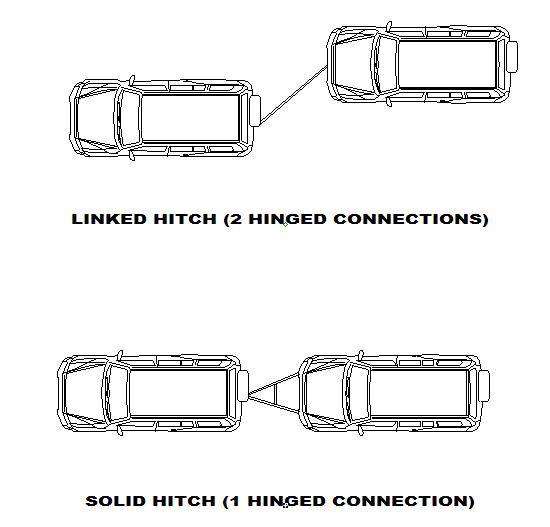

4ePikanini wrote:I also feel it is dangerous but can't quite workout why?
What is different to this trailer setup with four wheels locked in a straight position setup?
The difference is the solid hitch (only one hinged connection), which forces the trailer to follow the towing vehicle.
With a tow 'bar', the hitch has two hinged connections, allowing the 'trailer' to run in a different path than the 'horse'.
