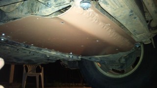

Spend the whole afternoon creating a temporary fix for the plastic belly plate that is broken and flapping in the wind. Got hold of an old Geyser housing, and created my own belly plate from it. its not thick metal but the 1.5mm plate should keep small stones and sticks at bay until i can fit proper protection.
not to bad for a pen pusher :geek: if i may say so myself :D
