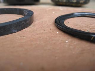

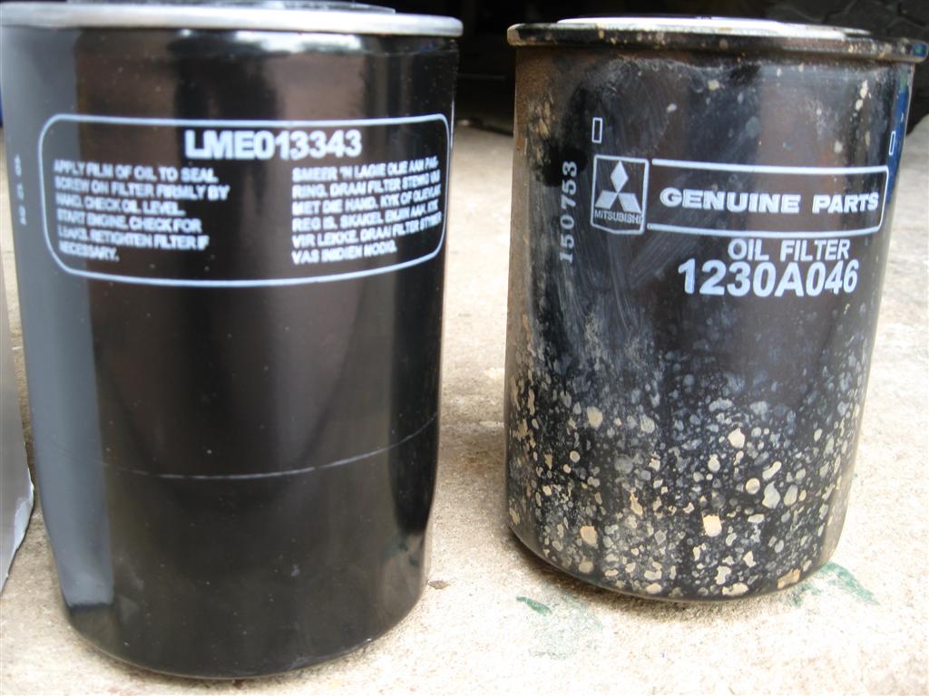

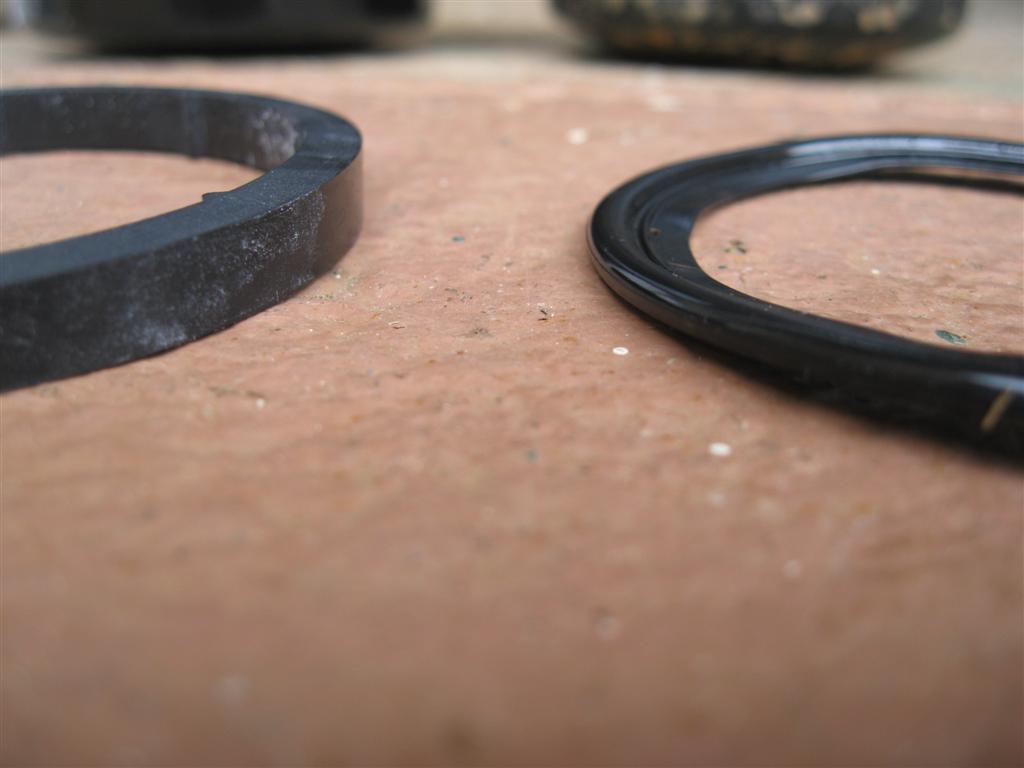

4e, I was referring to the diesel fuel filter (my bad), but I also have two different no's for the oil filter it seems. The old filter is 1230A046 and the new one is LME0 13343 (same as yours and on my previous service invoices). They seem the same size, but the top end and rubber seal ring looks different.

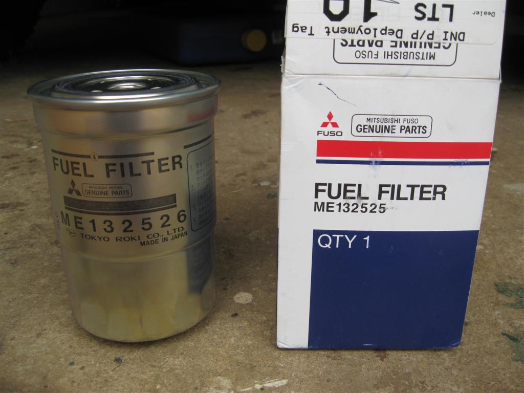

I also noted the new diesel fuel filter box shows ME132525 but the filter inside shows ME132526 (same as the current old one).
What's up with all these different filter numbers? :?:

I have just checked MMC ASA (Latest WinCaps) and it specifies for V78W chassis 2005 model the following part numbers
Oil Filter - ME013307
Fuel filter - ME132525
I do know, however, that mitsubishi constantly develops and improves their products so a revised part number may not show up on my software, but does on theirs.
