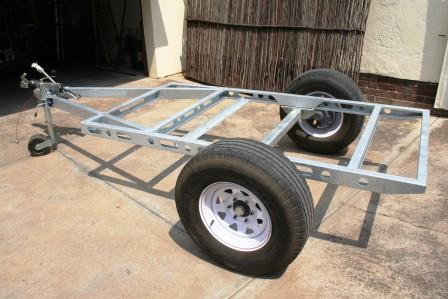

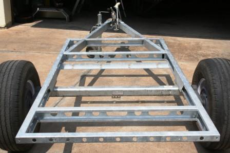

Just an update. I have received the chassis back from the galvanizers. The nice thing now is that now what you put on is complete and no more put and take off.

Question: I cannot see what type of suspension you have? How did you attach it to the chassis?
Please post some pics:)
I ordered a what they call a Rub-Axe. Commonly use on Caravans. I just went up on the loading capacity of the axel to 1,8 Tonnes. The axel has its own mounting bracket which i Just bolt on to my Chassis with 8 off M16 x 30mm 8,8 Bolts, Nylock nuts and washers.
