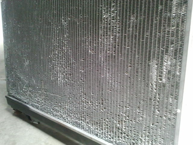

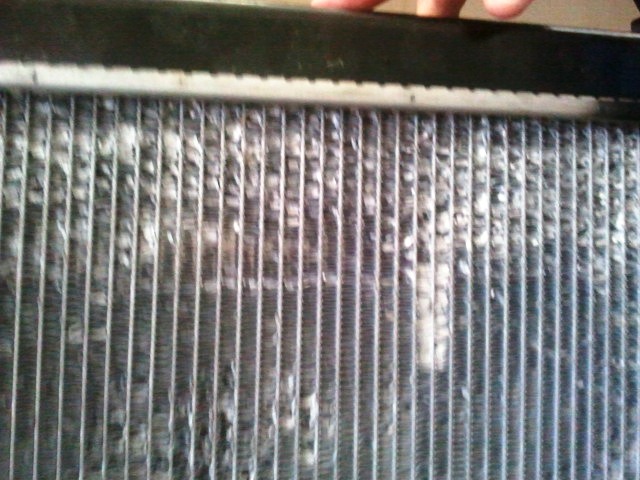

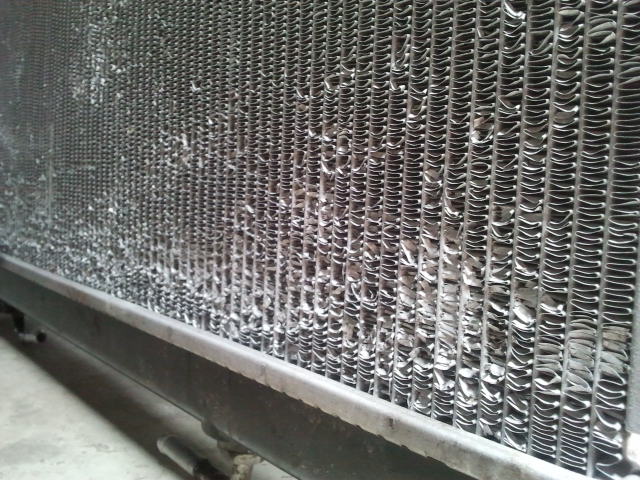

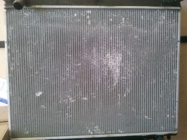

I have attached some photos of the condition of my Gen 3 radiator after it has been cleaned (apologise about th epoor condition of the close up view). There are quite a few areas that look pretty damaged and the dealers (and now independently Silvertons) has suggested that I replace it.
Any comments from you clever fellow out there?
the top pic is a view from the front and the bottom pic a view form the back of the radiator
How did it get to that state?
Somebody really manhandled that radiator, most probably when the engine was re-built.
(I always fit pieces of thin hardboard to the front and back of the radiator when working on the engine. Cable-ties through the core work well. Remove only once the radiator, fan and belts have been fitted).
Seeing your pics, I think it needs replacement, as well!

Yip,
I don't think any Pajero deserves to be cooled by that radiator.

Hi Roelf
Yes one look at that radiator (once it was out) and I was confident it needed to be changed.
I think it was damaged during the rebuild. To be fair it was very soft and brittle when I pushed on it and so the damage was probably caused quite easily.
Having said that though I am not 100% sure as this is really the first time I had looked at when it was out of the vehicle. So it could just as easily have been damaged when it was sent in for the acid bath.

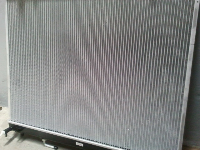

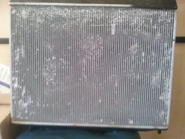

Some better pics of the old radiator and one of the new radiator that is currently being fitted
A rather big improvement!
Same very steep test hill, very similar ambient temperatures, VERY DIFFERENT RESULT! This time with the new radiator and viscous fan fitted the temp gauge didn't even reach halfway!
