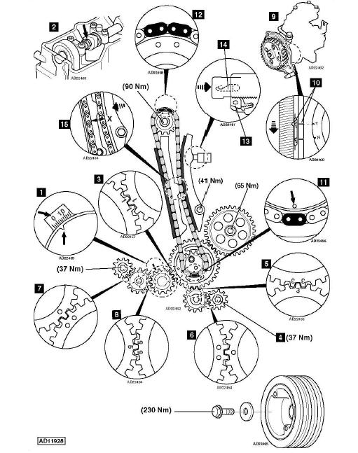

To add to Marius' keynotes, some info on the timing set-up for the 4m40 TD engine:
General precautions
General precautions
- Disconnect battery earth lead.
- Remove glow plugs to ease turning engine.
- Turn engine in normal direction of rotation (unless otherwise stated).
- Observe tightening torques.
- Do NOT turn crankshaft via camshaft or other sprockets.
- Do NOT turn crankshaft or camshaft with timing chain removed.
- Check diesel injection pump timing after resetting valve timing.
- Ensure crankshaft at TDC on No.1 cylinder.
- Ensure crankshaft pulley timing mark aligned with 0° timing mark on chain cover [1]11928.
- Ensure notch on camshaft points upwards [2]11928.
- If notch not visible, turn crankshaft one more turn.
- Install timing gears as follows:
- Ensure crankshaft gear and intermediate shaft gear timing marks aligned [3].
- Install LH balancer shaft [4].
- Ensure timing marks on intermediate shaft gears and LH balancer shaft gear aligned [5] & [6].
- Ensure RH balancer shaft gear and oil pump gear timing marks aligned [7].
- Install oil pump housing complete with RH balancer shaft.
- Ensure timing marks on oil pump gear and crankshaft gear aligned [8].
- Install injection pump as follows [9]11928:
- Ensure notch on injection pump gear aligned with mark 'T' on flange [10].
- During installation of injection pump: Notch on gear moves in direction of arrow.
- Install timing chain as follows:
NOTE: Camshaft sprocket bolt has LH thread. - Ensure crankshaft gear and intermediate shaft gear timing marks aligned [3].
- Align bright coloured chain link with intermediate shaft sprocket mark [11].
- Align camshaft sprocket timing marks with bright links [12].
- Turn cam on tensioner [13]11928and push plunger into tensioner housing. Lock tensioner with hook [14]11928.
- After installation remove hook to release plunger.
- Check timing chain for wear as follows [15]11928:
- Push timing chain tensioner in direction of arrow and measure clearance 'X'.
- Replace the timing chain if the measurement 'X' is 9 mm or less.
