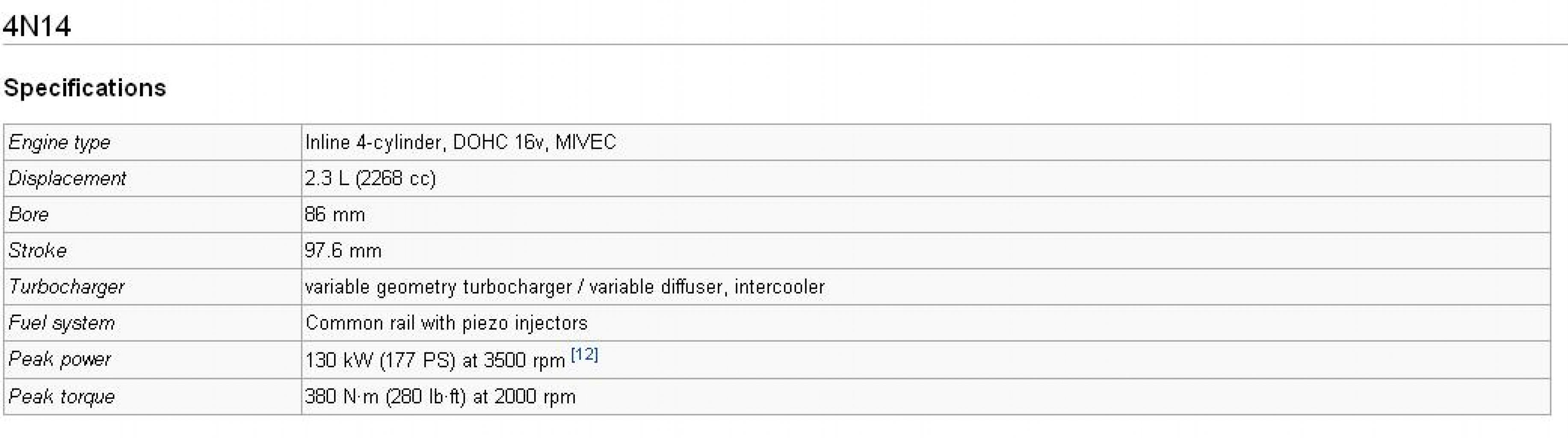

The 4n14 (as used in overseas Outlander) is as (if not more impressive)!
At 130 kW and 380Nm, it has higher output than my Di-D, from 2.3 litres!
