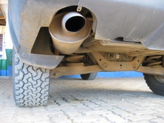

The last 6 fill ups give me a average consumption of 8,63km/L with a roofrack on.
I did feel a slight increase in the power when going up hills and mountains - it does not kick back to 4th gear as easily as it did previously.
See the pics below. The center box, if done right, will not affect your ground clearance. I have the following free-flow boxes from the front going backwards:
Front - resonator
Center - large round box
Back - small oval box
Front box
Front box
Middle box
Middle box
Middle box
Middle box
Back box
Back box

zeek wrote:
4ePikanini wrote: Would also liek to have that big box otu of the way as it looks way to vulnerable for rocks.
I would think your fuel tank is more vulnerable, or my silencer is less vulnerable than yours - depending who fitted it and how.
