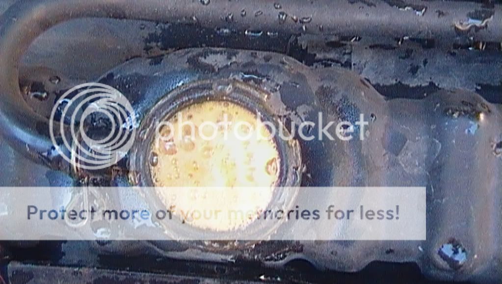

i was reading on the condom hg test and i did it. please check the pictures. my radiator top has some brown sandy like paste around it. the water (yes water, i removed the thermostat as it was faulty and topped with water planning a full service this week) is browny as if it had been mixed with sand.
please tell me if my hg is gone or not. if its gone will it mean that its loosing power and drink fuel because of it?
