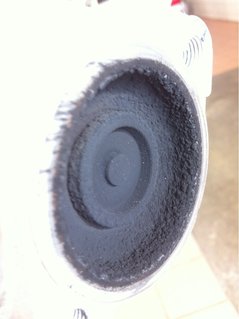

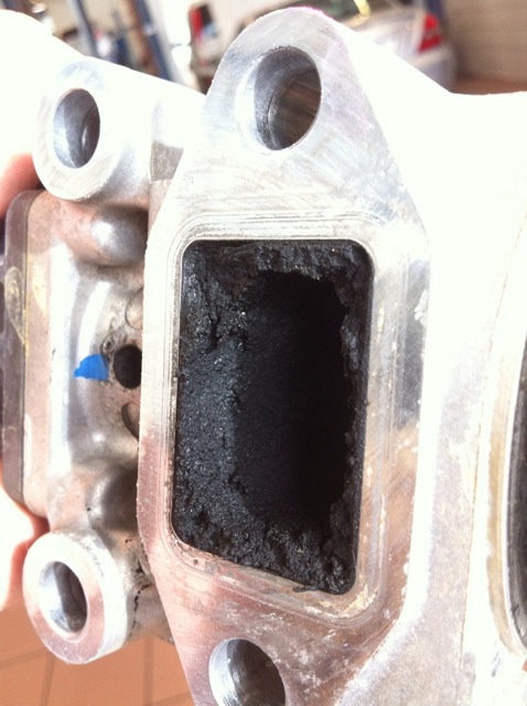

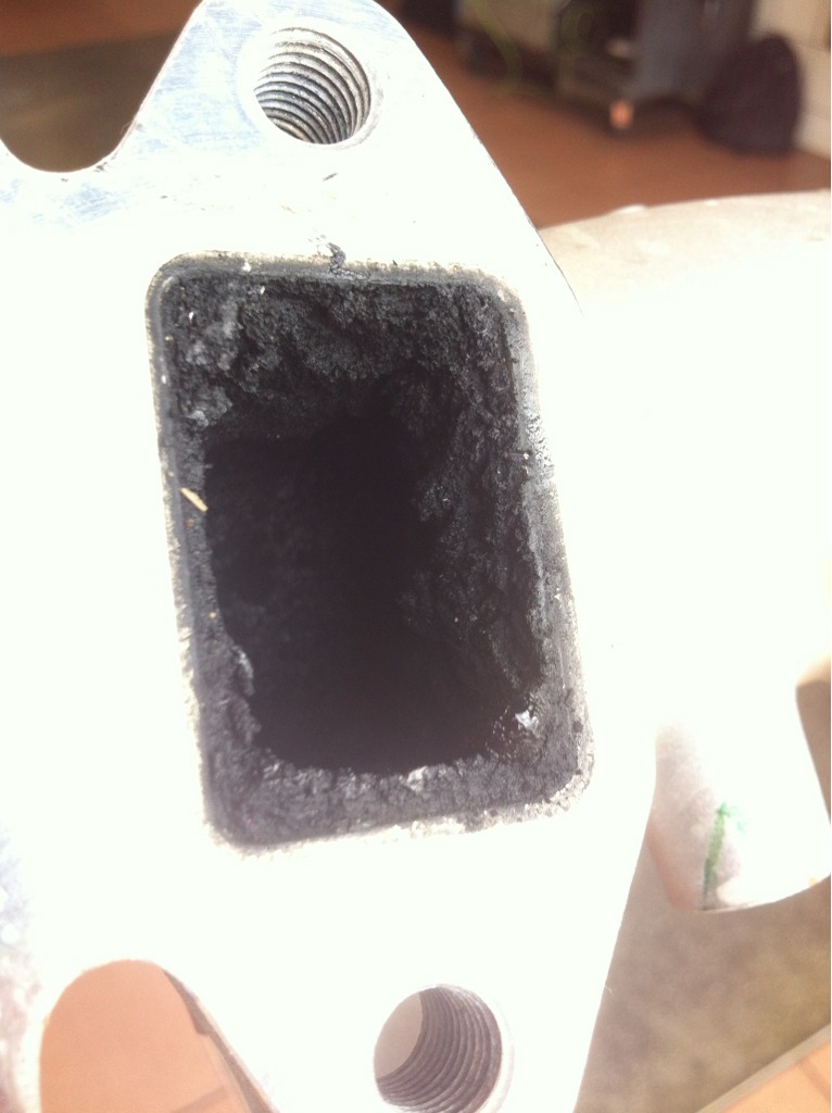

This is what my inlet system looked like 3000km ago (92 000Km)
Dealer - So, as you can see, its all carbon'd up. Fuel is really bad in South Africa. contaminated.
