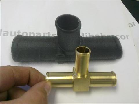

Hi all,
Eventually got my T-pieces back a a cost of one can of Coke
They are butifully made from solid brass ... I'd hate to know what the real cost was ...
Will be fitting on the weekend.

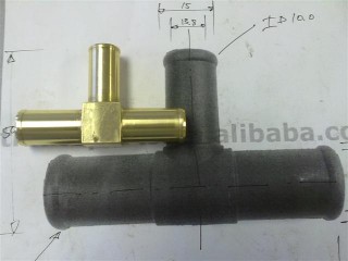

Redvers asked for the dimensions ... I attach my very profesional drawing and just wish to make a couple of clarifications the shop asked me:
- Dimensions are "more or less" but good enough
- The 15 and 18 dimensions refer to the "lip diameter", with 13.8 and 16.8 being the actual outside diameter of the tubular parts
- The internal dimaters are 10.0 and 12.5 respectively
- The length of the 13.8mm leg is +/- 32mm
