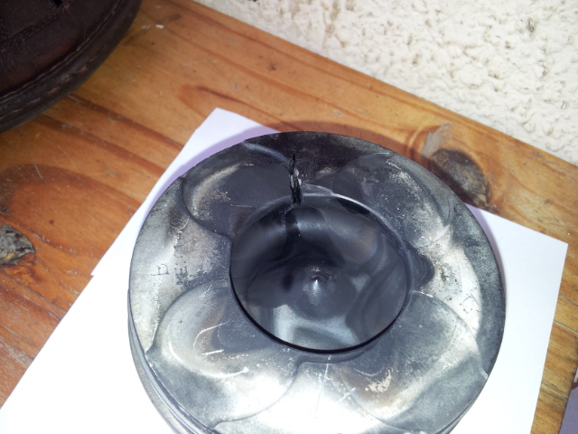

PJB
Re: Engine failure
Hi all,after reading Entabeni,s 6th Feb post I should change my subject to the same as his!!
My piston damage is the same even down to split in gudgeon pin hole.
My engine is being fixed by Eagleharm engineering in Springfield Park Durban,they were recommended by agents and so far I am happy with them.I should get my car back next week.One thing they did say was that they only fit after market pistons, not sure why maybe a supply problem
Just bye the way this was the first trip where I added two stroke oil to 50ppm diesel,I wonder if this caused any after burn after TDC on the power stroke.I also had three 500 ppm fillups on the West Coast from Senderlings Drift down.Maybe one had water ect in it :(

Re: Engine failure
another try at posting photos
andrew.ashton
Re: Engine failure
Hi PJB,
Thanks for the posting and photo.
Sorry to hear about your problem.
1. Any chance that you could post any more images showing the crack - for instance from the gudgeon pin side?
2. Had you experienced anything that sounded like pre-ignition / pinking?
