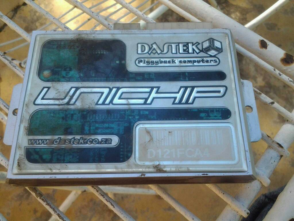

Ok....its a few months later......time for some feedback.....I finally had the guts to remove the chip. Drove around a few blocks. All seems ok. Driving to Bloemfontein tomorrow. Will give feedback on powern and consumption after the weekend.
Chip details: Dastek piggyback computers. Unichip D121FCA4.
