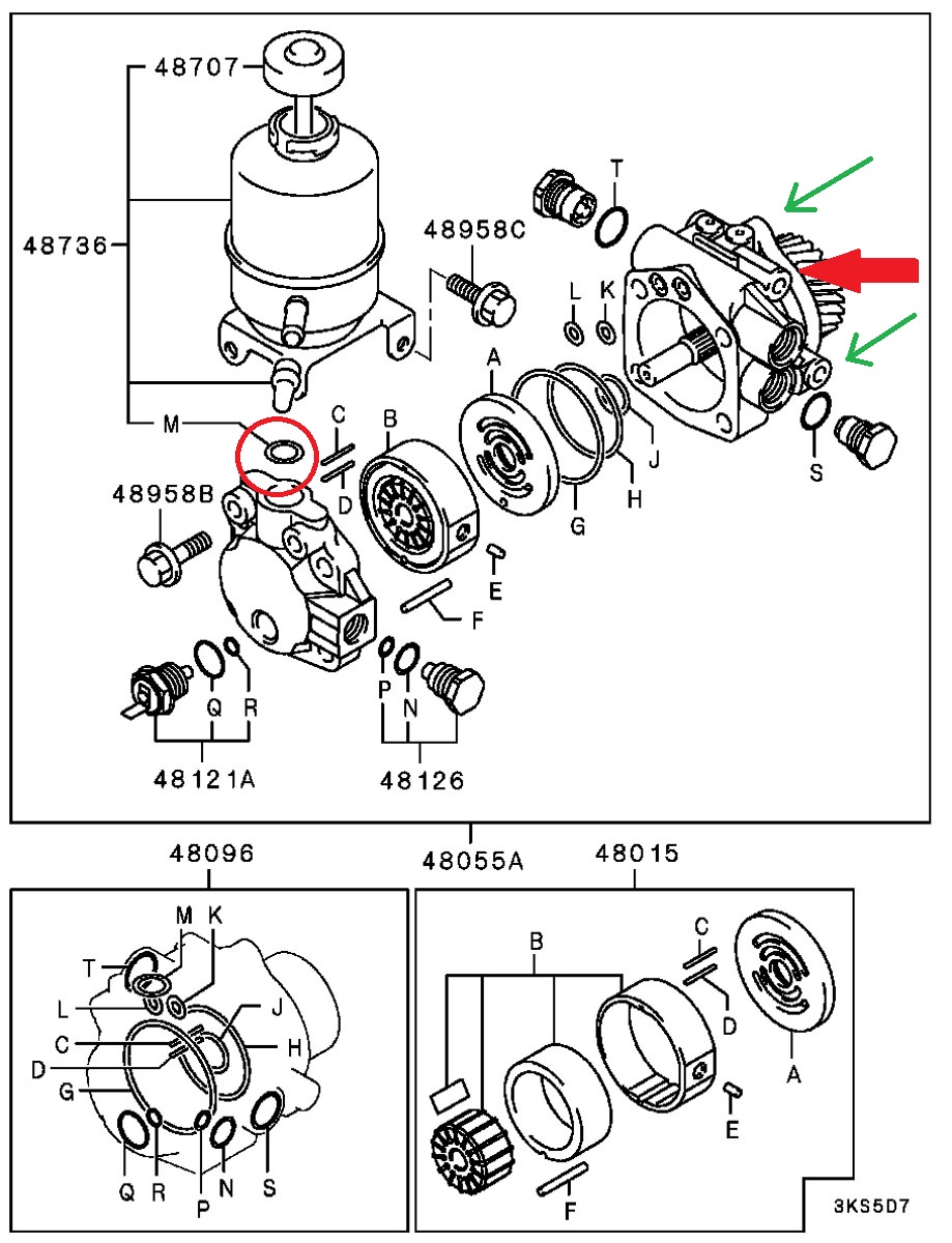

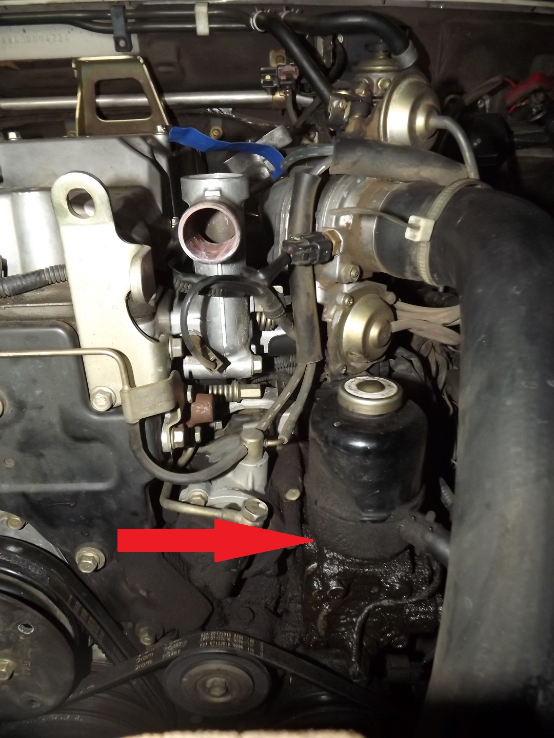

I recently repaired the leak on my power steering pump. It helped that a lot of stripping was done as I was replacing the head. See the photo below of what the leak looked like as well as diagram on which O-rings I replaced.
It is advisable to power wash the area before working on the pump - it prevents the oil soaked grit from getting into the pump and pipes when you work on it.
The first leak was between the fluid reservoir and the pump, on top. The second leak was between the pump and the engine, at the back.
As mentioned above, in order to repair the first leak under the reservoir, you need to remove the whole pump. One cant' only remove the reservoir as there is a bolt that you can can reach, but there is not enough space to get it out completely. I tried.
First drain the hoses from steering fluid then plug the hoses - prevent grit. Then take a small transparent piece of pipe and suck out the reservoir itself, rattlesnake-venom-suck-out style. It makes a mess if you dont.
Do not loosen any bolts on the front side of the pump. Only the two mounting bolts at the back (see the green arrows on the diagram). The top one is ok, but the bottom one will need some stripping, long extension socket and a flexible joint.
Next, I simply went to a local power steering repair shop and asked for similar O-rings. They gave both to me for free. When inserting the reservoir O-ring, apply a little grease to help ease it back in and so prevent miss-forming it.
Reservoir leak and O-ring position
Green arrows - back bolts
Red arrow - back large O-ring
Red circle - reservoir O-ring
