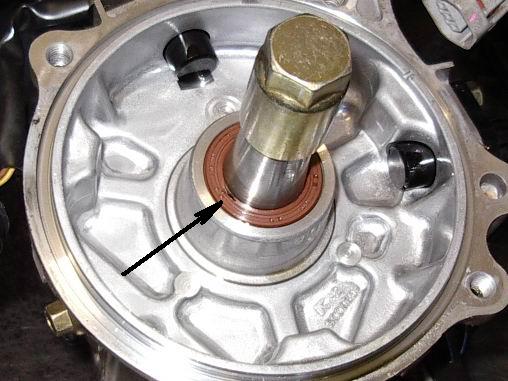

I had the same problem.
I investigated all possibilities, including a leak in the return rail etc.
The volume of diesel finding its way into the sump, pointed to a rather serious leak somewhere.
It was eventually fixed when the pump shaft seal was replaced.
(it is a Vexel VP44 pump, so the seal should be available for a few R at any diesel specialist)
Don't delay, the consequences can be very expensive, because the sump oil is degraded.

Thanks for that 4ePajero. Yes, this was a big suspicion as you say so we took the pump to the local diesel pump specialists who replaced this seal. When we put it back on, it was still putting diesel into the sump at about the same rate. So, either this is not the problem, or, it is the problem and the new seal is leaking the same as the old one. And if it is, why? Strange one.... I understand this seal is on the 'low' pressure side of the pump so unless there is a build up of pressure behind it, I don't see why it should ever leak. Wierd...

Thanks Pikanini. Yes. Also if the bearings are excessively worn, this could damage a new seal too, but all 'looks' to be OK, shaft and bearing.
