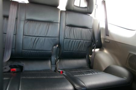

Overall:

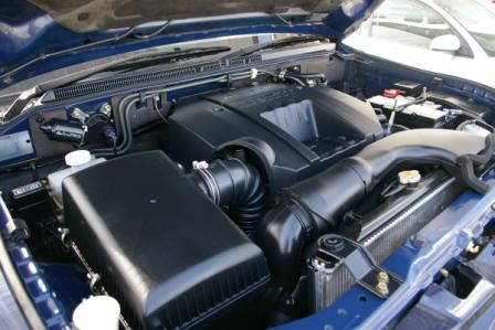

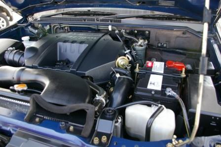

The Pajero seems to be in good condition and had acc. to the dealer only 1 owner before, 166,625 km on the clock. I took 2 fotos from the engine which was steamed and properly clean - so impossible to detect any leakages or oil on the block. The interior is in marvelous condition, black leather, no tears and dents. It has front fog lights, electric drivers seat, seat heating for the front seats (mösenstövchen), traction control, 6-CD changer, 2-H, 4-H, central diff-lock and 4LLC - so all you need for our desert trip...

- Ashtray for the back passengers in the middle box missing,
- no cover for the boot (the dealer told me it's in the shop - I doubt this because the side holders are not mounted in the car...
- no dents outside, nice blue metallic colour,
- no toe bar...

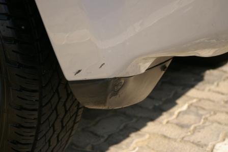

- a few scratches at the front and back bumper (it's plastic - I had on mine the same)

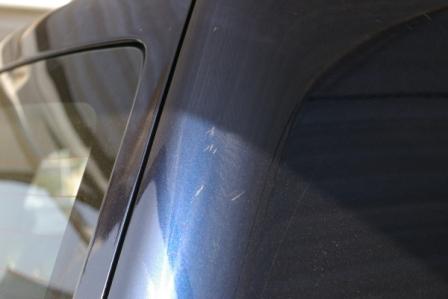

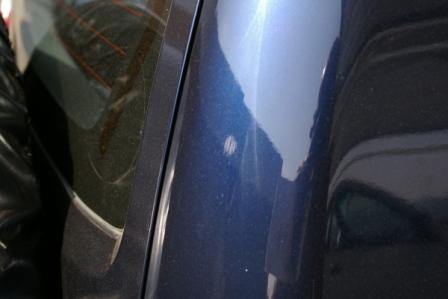

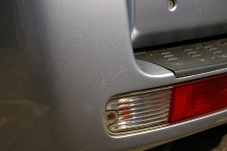

- a serious scratch at the right back window, already rusting (see foto).
- it is a smokers car

1. The scratch at the right back window is a serious one and with metallic colour not properly to fix,

Overall:
Details:
Looking a bit more into the details - I found the following issues:
- no toe bar...

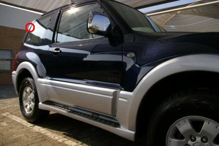

The superficial scratches don't really bother me - it's a 4x4 and this is to be expected. The bad scratch on the back window, where exactly is that - it's hard to tell from the photo? So you think this can't be prepared properly?

The scratch on the back window is at the "frame" of the window. I've marked it on the pic attached. The didn't smell much - it was just a "side"-observation. For around 150.000 ZAR I would consider to buy it, but not for the current price. My concern is a bit the missing cover in the boot and the fact that it comes w/o any extras...(toe bar, etc).
