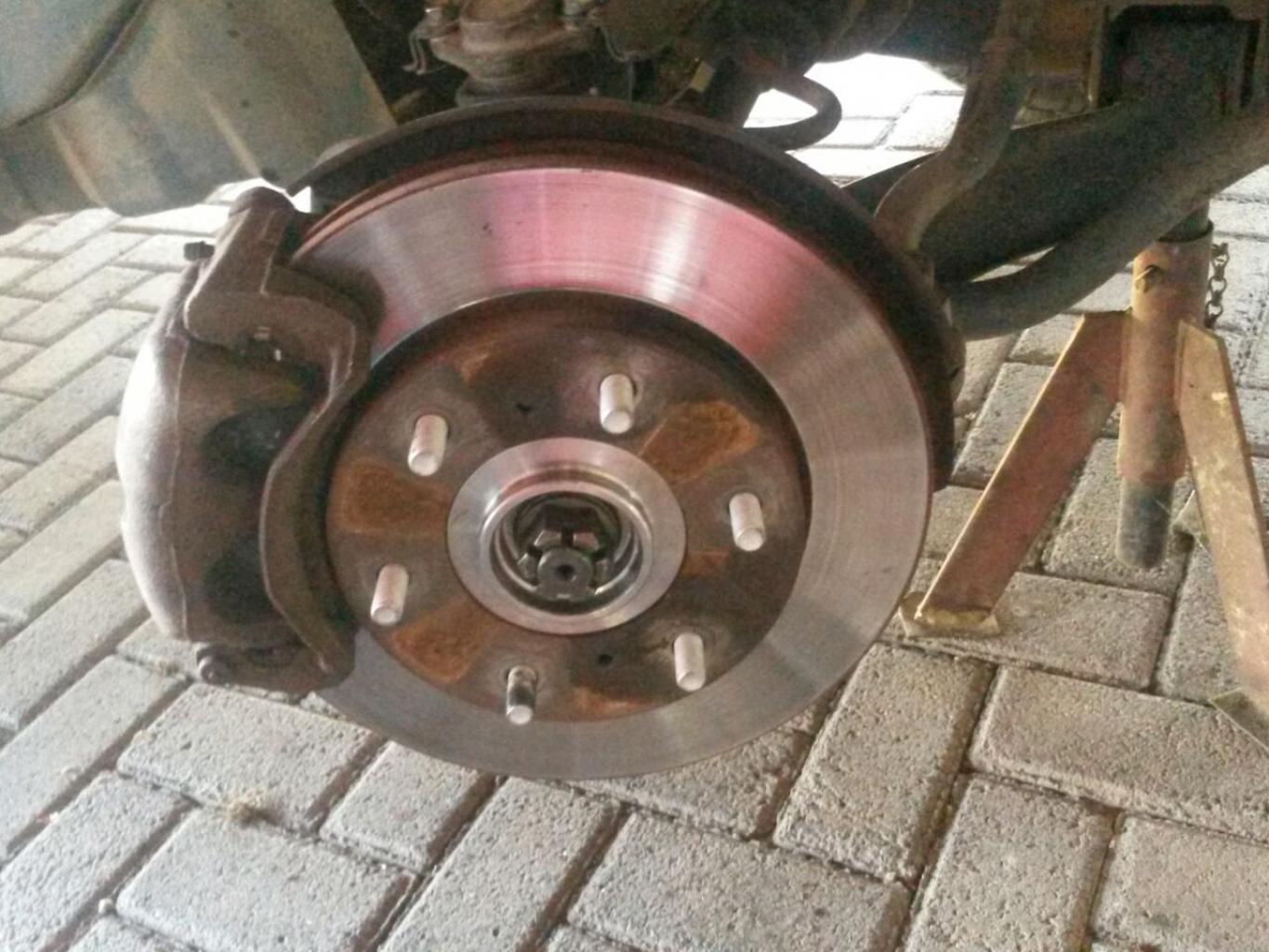

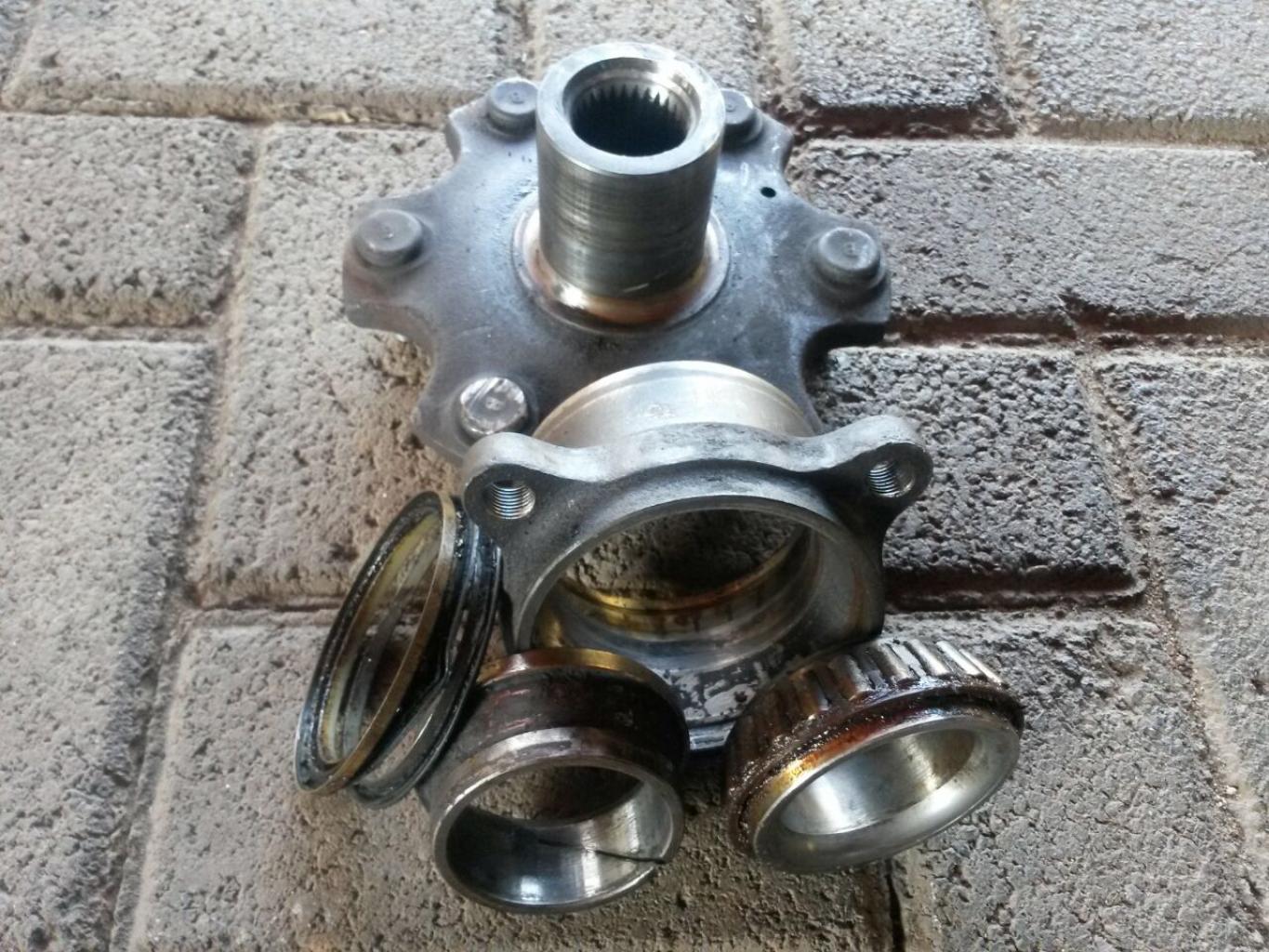

Mine started with that metal-on-metal sound every now and then. I decided to strip and relace after 320 000km on the clock. Only to find out today that the bearing assembly is only ex-Japan available @ R3.5k each. Can that be true??
I started to source at all bearing suppliers to find a NSK 50KWH01E for just +R1k. The original one exactly the same number with suffix "/b" following the number.
Anybody knowledge on using the NSK bearing?
Feedback will be appreciated before I import or buy the local one.

Thanks Cats. The link was very helpful, however I managed to install the NSK 50KWH01E hub purchased from BMG under item code JWB3066 for +R1k.
The following link gives the different hub bearings from NSK: https://www.google.co.za/url?sa=t&sourc ... 6LN1jE0Ivg
For that price, I will definately do the remaining 3 as a preventative measure.
