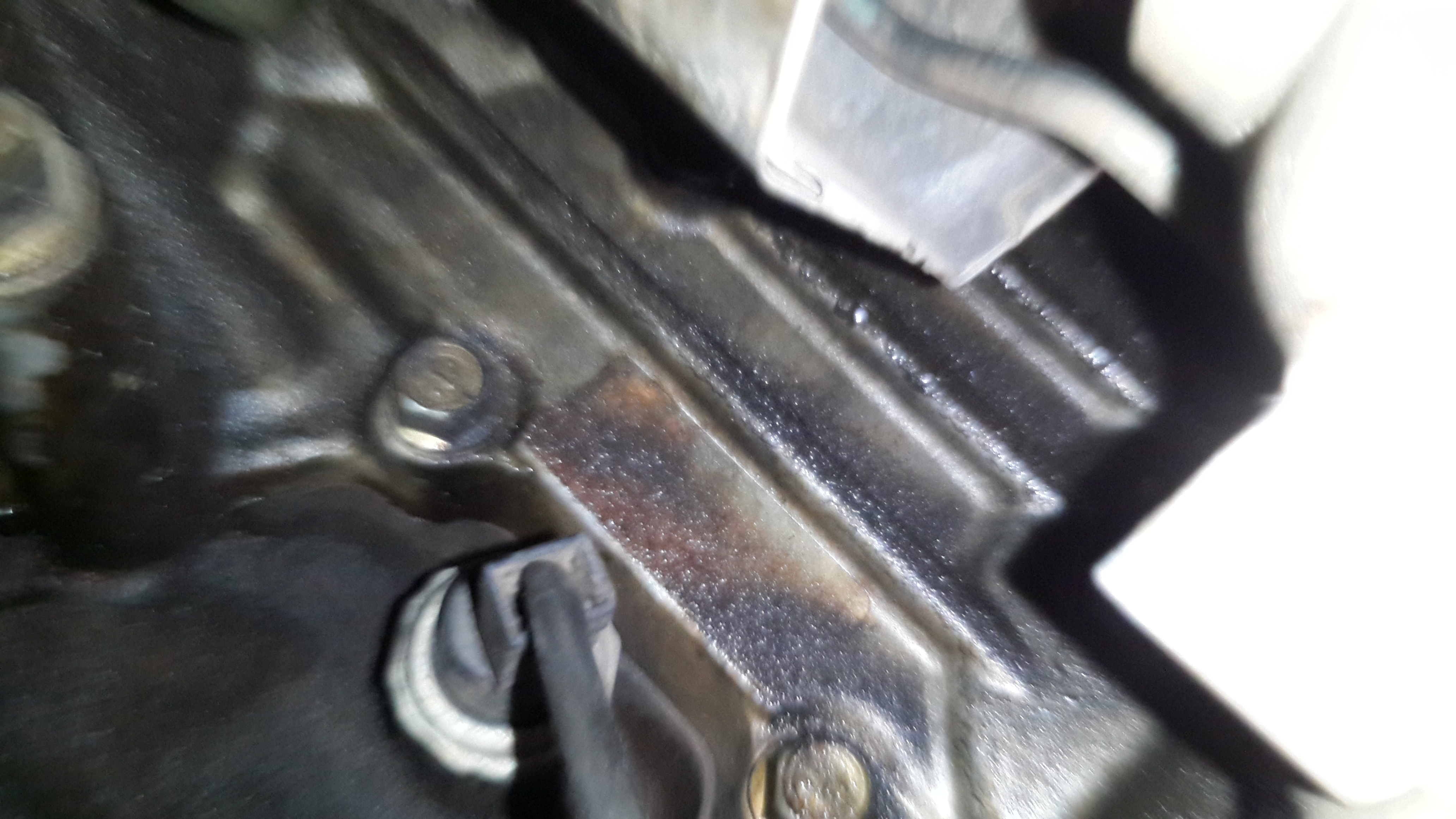

Hi Guys,
I'm having the same problem, but can't ID the problem. checked the switch and looks dry, as per the photo, changed the oil filter and still have a oil leak.
Is there anywhere else I can check.
Derek
