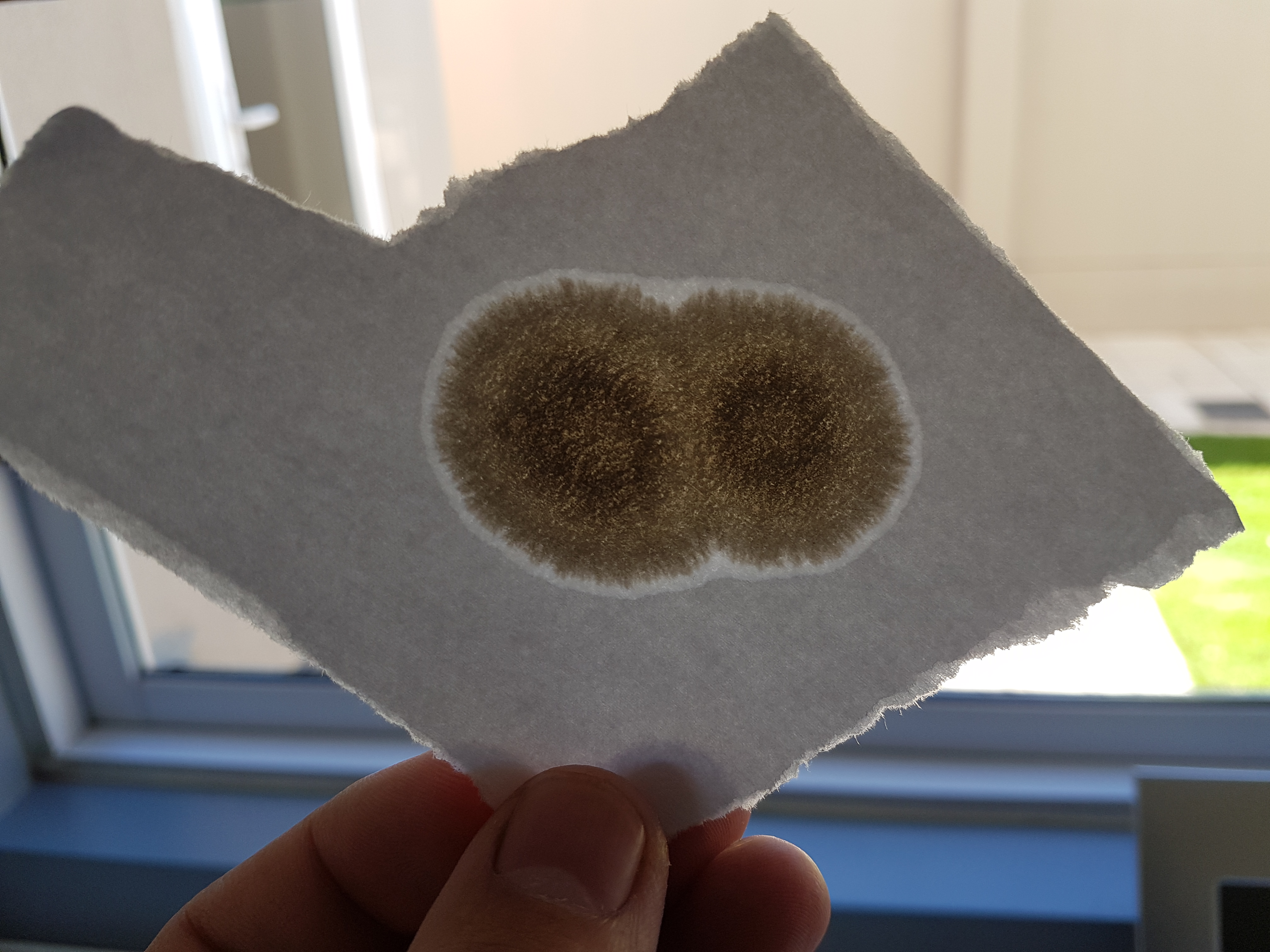

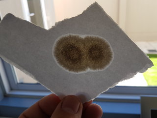

So here we have the test as suggested...
As all can see, I do have some diesel contamination, however considering the sump is 9.6l and i've drained around 2 sumpy containers (how many liters is a green sumpy?) without filling with more oil and its full again, that means it should theoretically have a lot of diesel if that was the issue...
However the image shows very very little diesel halo ring, and I would expect a lot more for the amount right?
So next I look at the jagged edges just inside the diesel halo... That screams overused oil or anti freeze or water right?
Since this oil has only done +-3000km, doubt its the oil problem... however i did have some overheating while pulling a heavy trailer loaded with bikes (+- 800kg), up long hills, 36 deg and radiator full of grass seeds blocking air flow (only found out after). Which might explain the oil degradation?
I looked at my coolant bottle, it has not moved in liquid height since I first noticed this problem a little while ago (+-2000km), and surely I would have seen that many liters change? (under radiator cap is also full so cap is working as expected)
Also no bubbles in the radiator cap area when car is running, nor milkyness or foaming in radiator or under oil cap... However I did see some steam escaping from the oil cap when I opened it after a drive... Thought that was strange? could be water evaporating?

Now this is the first time I have ever had to gauge a sample from a photo but from what I can see it certainly looks like a lot of diesel. Simply the fact that your sump capacity "grew" by about double its size confirms that. I certainly would not drive the engine with that amount of diesel in the engine oil.

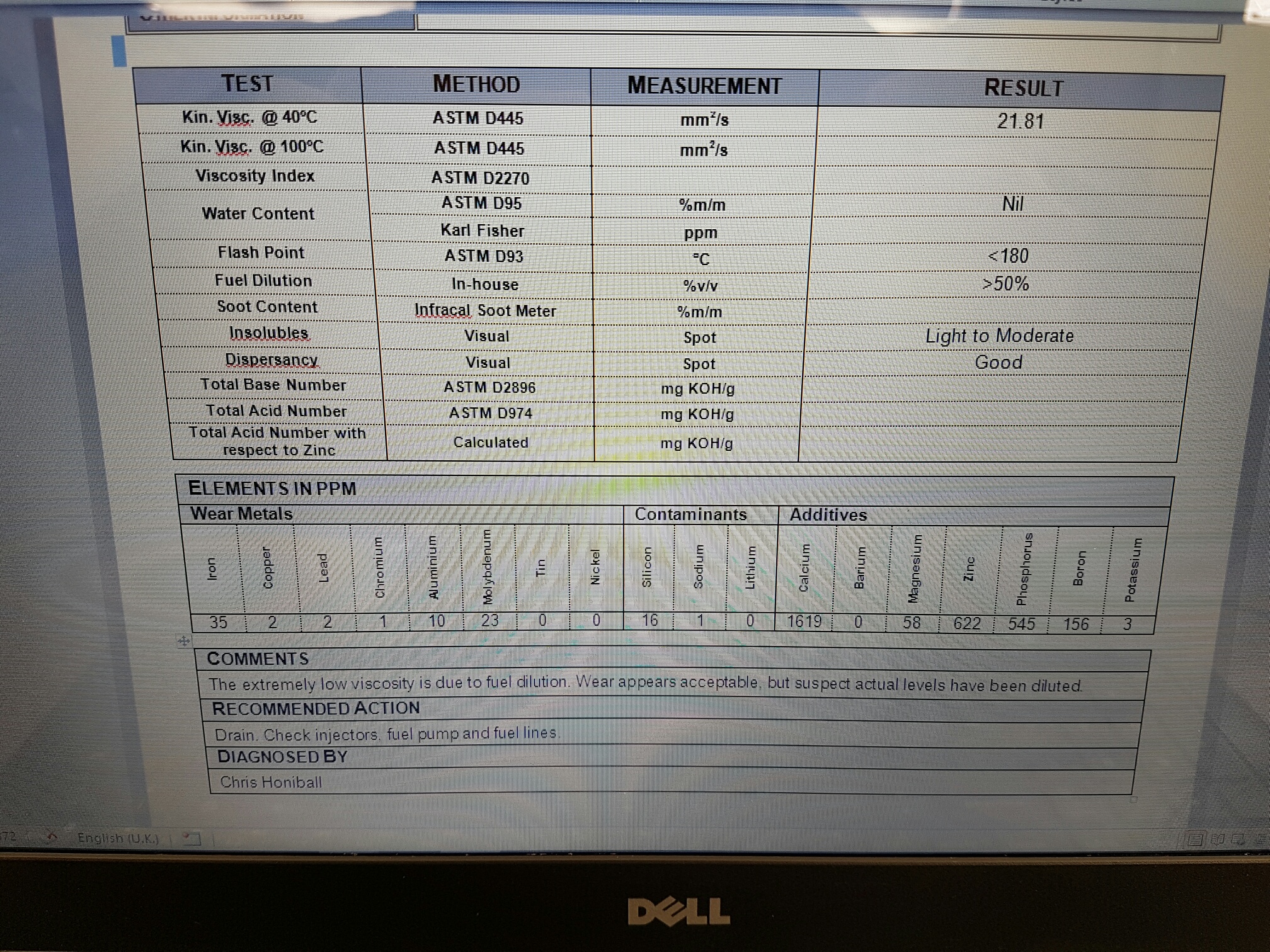

Hey guys
Thanks for all the feedback...
Got my results back from the lab... you guys were right...
Luckily this isn't a daily driver so has done very very little distance in this state... On the bright side, im expecting to have my fuel consumption improve
Ill be draining it completely and filling with new oil to get it to the mechanic

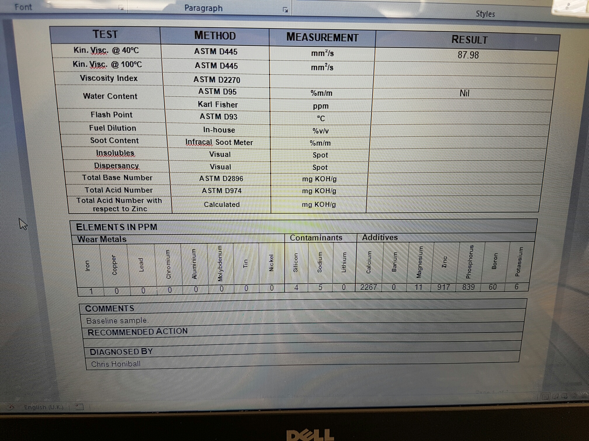

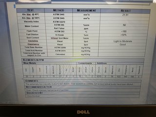

Attached is the lab results if anyone is interested
2 results, 1 is the comparison sample, other is used oil
