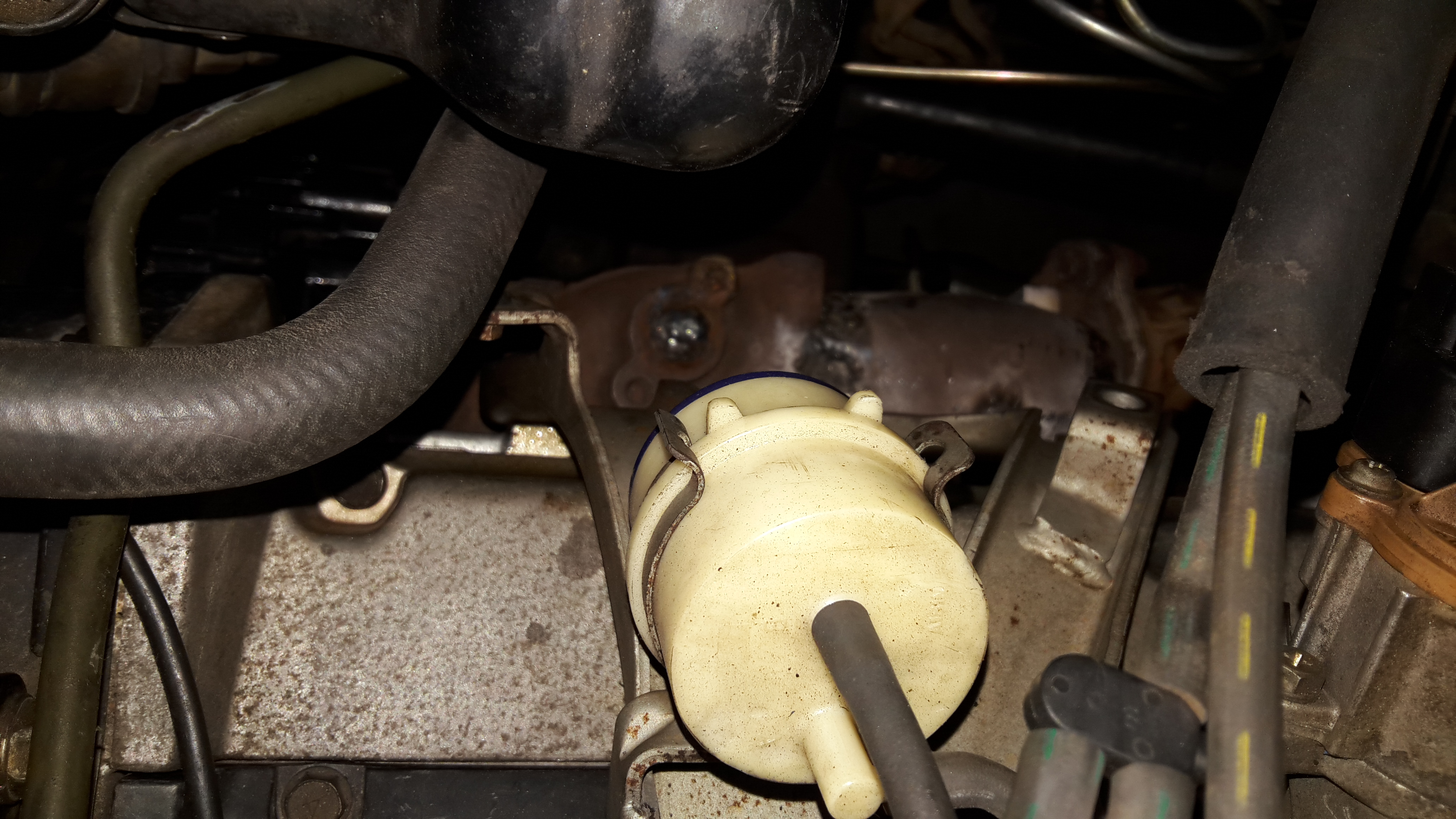

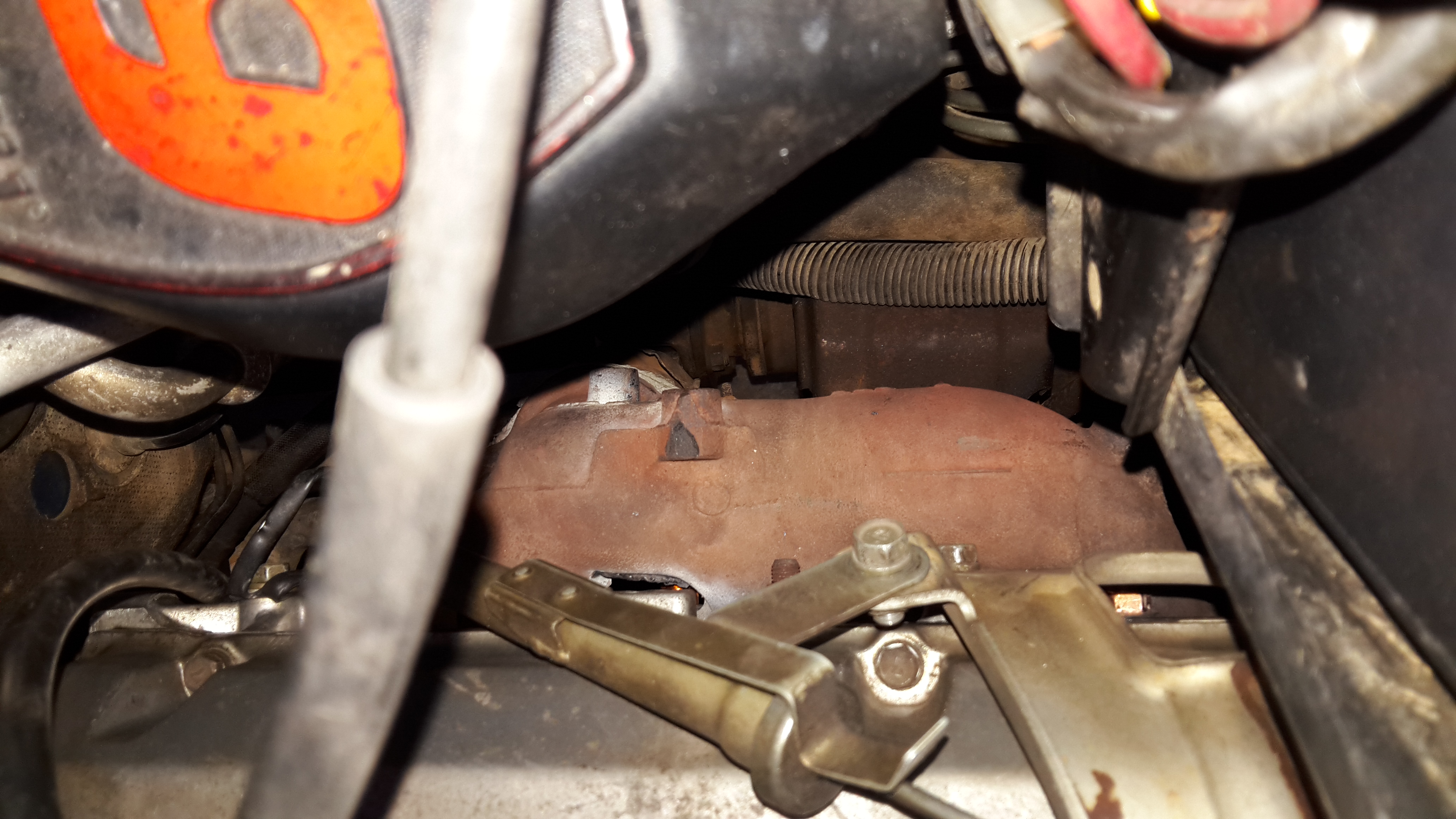

I collected my car today from Powerflow today.
Both exhaust manifolds were cracked, the labour time was 6 hours, to strip, weld, skim and refit at a cost of 3k including labour and parts.
Power flow also advised that I run without heat shields over the manifolds. I took his advise and request that he should not fit them back on again
