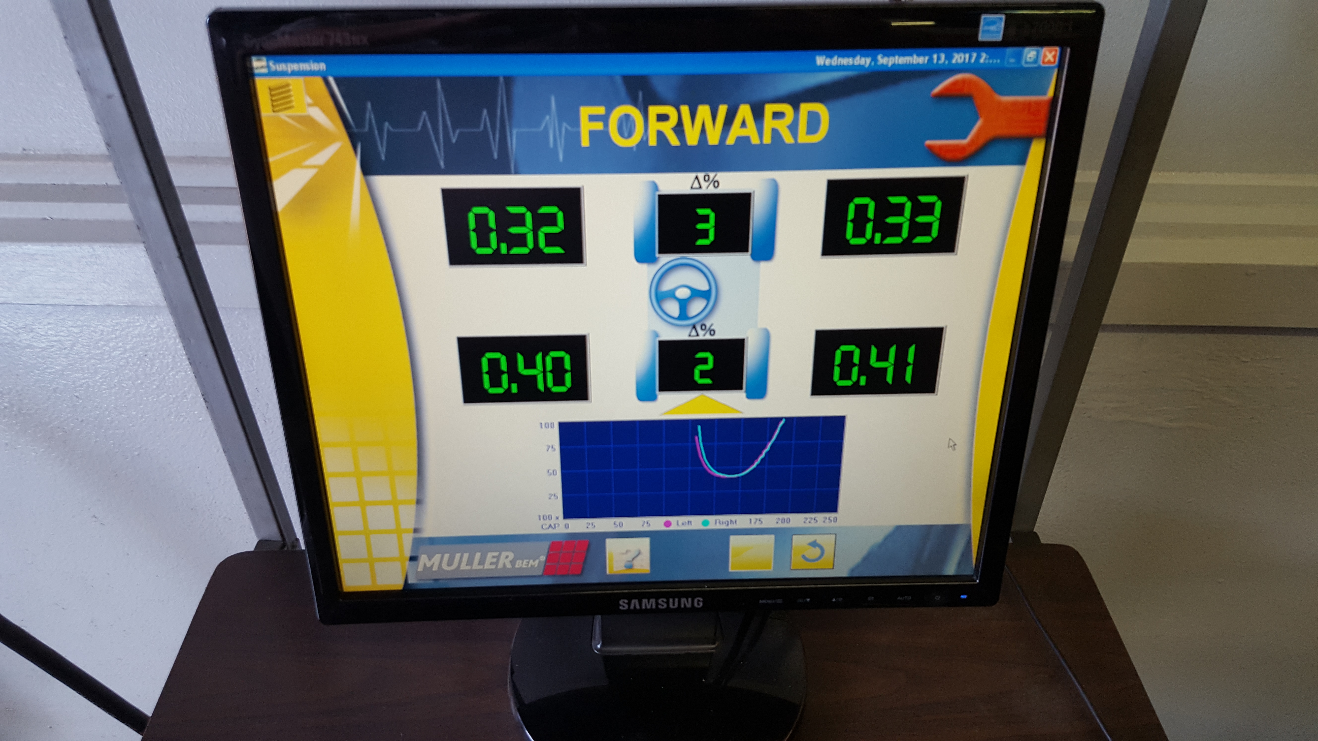

Hopefully someone will be able to point me in the right direction. I find that my car rattles like crazy on small rough sections of tar road. I have 1 x section of rough tar between my office and home and have noticed that the rattling is particularly bad and harsh over this section.
I also drive a badly corrugated section of gravel road on the way to my friends farm and it sounds like the shocks go into stiff mode and don’t give over these short sharp bumps. The best way to explain it would be like solid shocks on these bumps but they appear fine on all other bumps.
Any ideas what could be the problem or do all Pajero's have a harsh ride over small sharp uneven roads. I don’t remember my car having such a harsh ride on small bumps. Maybe it is my old age catching up and me becoming forgetful.
These shocks have done around 70 000km and originals supplied by Mitsubishi.

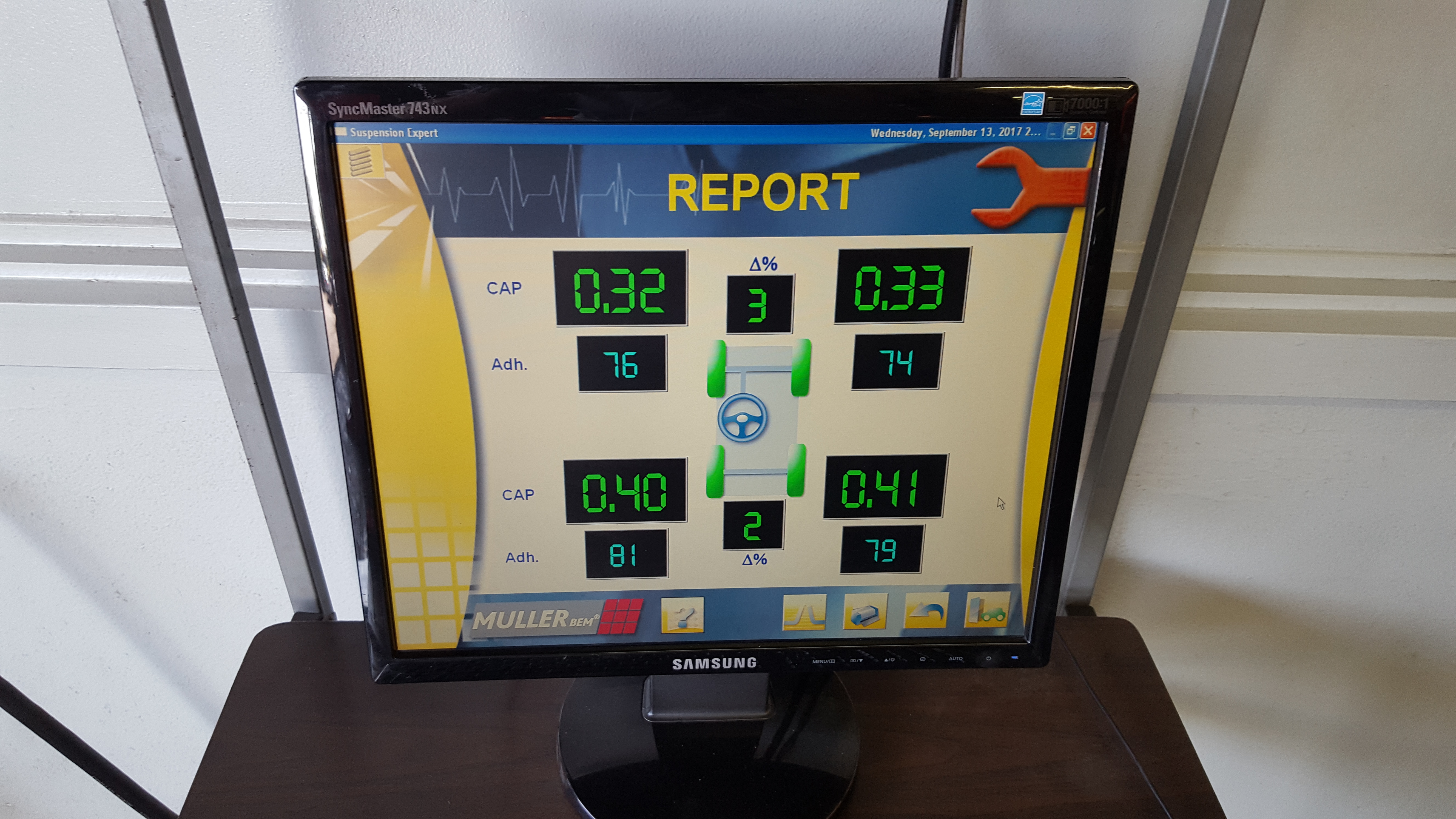

I had the shocks tested on a Gabriel shock tester and the dealer said they are fine. Can anyone explain the numbers on the attached pictures.

Any comments on the shock absorber graphs?
