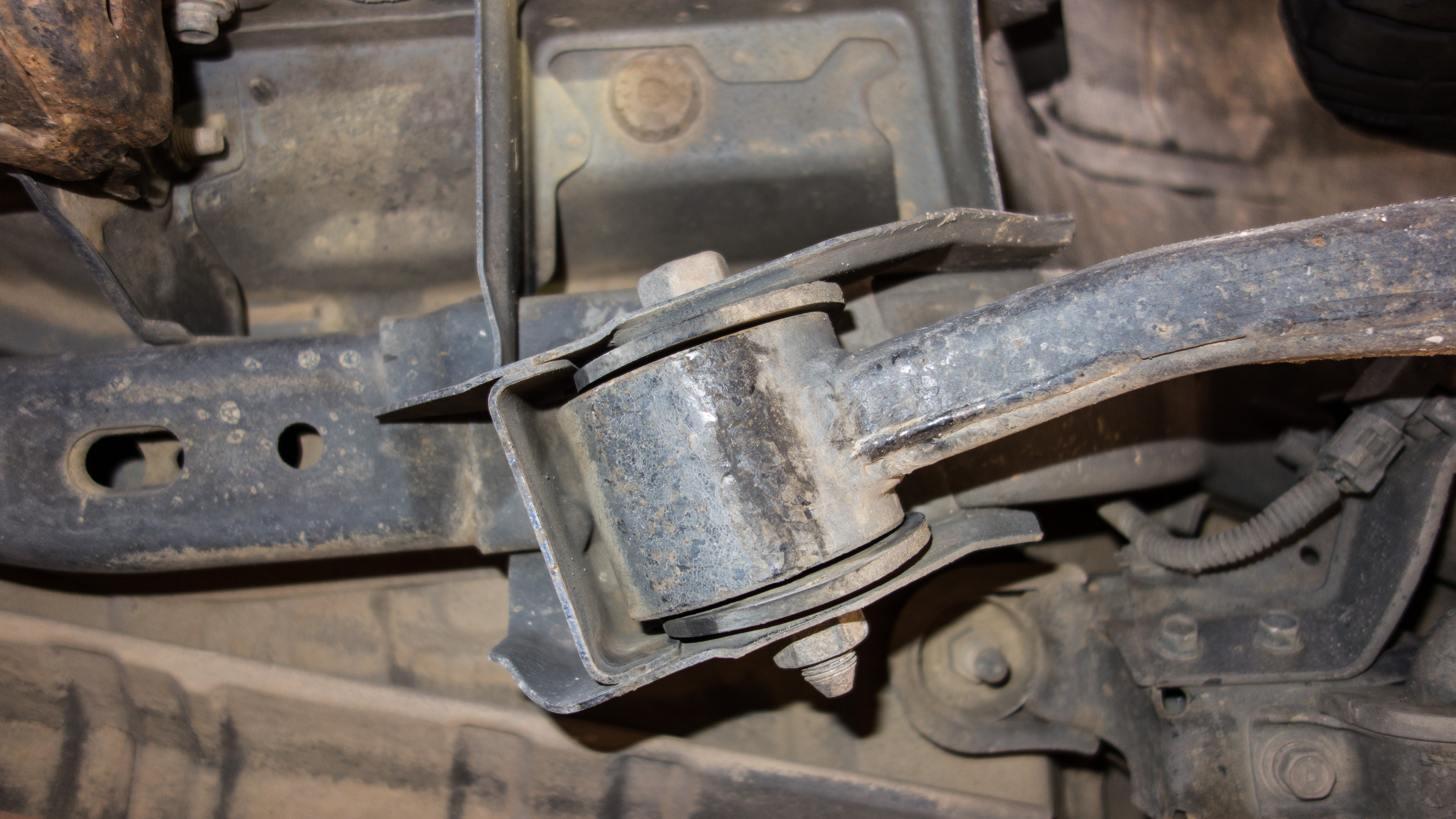

I was under my Pajero Gen 4 auto this morning when I noticed that the trailing arm was 'offset' against the mounting rubbers.
Is this normal or does it show excessive rubber softness?
The vehicle is on al almost level driveway (slight drop to the rear) and rocking the Pajero one can see there's quite a lot of 'to and fro' movement on these bushes where the railing arm connects to the chassis.
Normal movement or a sign of worn bushes?
Note there are some marks on the steel (no idea how they got there) but also on the rubber 'rings' that are visible on the bush sides (areas that are black instead of dirt coloured. The black (clean rubber) area on the right side bush is a little 'flat' rather than round showing some wear.
I would be gratefully for any comments.

I had the bushes on my Gen4 replaced at about 140k km. A suspension shop simply pushed new rubber bushes into the place of the old ones. I did the front wishbones and all four shocks at the same time. It really isn't a big deal.

I think it's normal. I was also concerned, but after replacing the bushes on both ends (with rubber, not poly) on my 2003 Gen3 at 320 000km, I can still quite easily twist the trailing arms by hand. The front bush is not solid rubber, it has two quite large voids. I guess it needs to cater for some change in effective length as the suspension moves, so a stiffer bush may well transfer more harshness.
