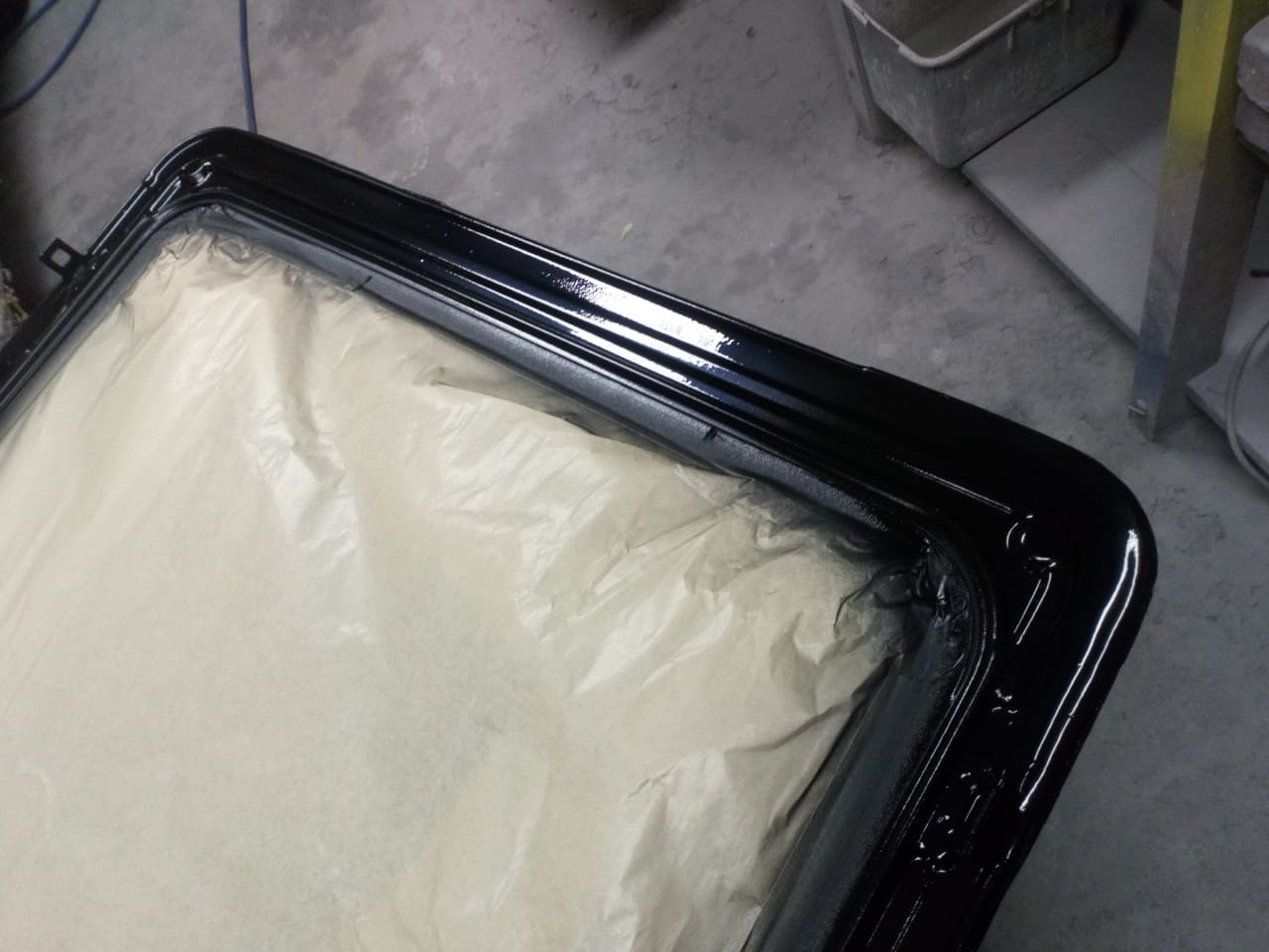

Fix in progress. Ching had to build a new 'lip'. The frame was very badly rusted.

Ching asked me R1800 to fix my sunroof.

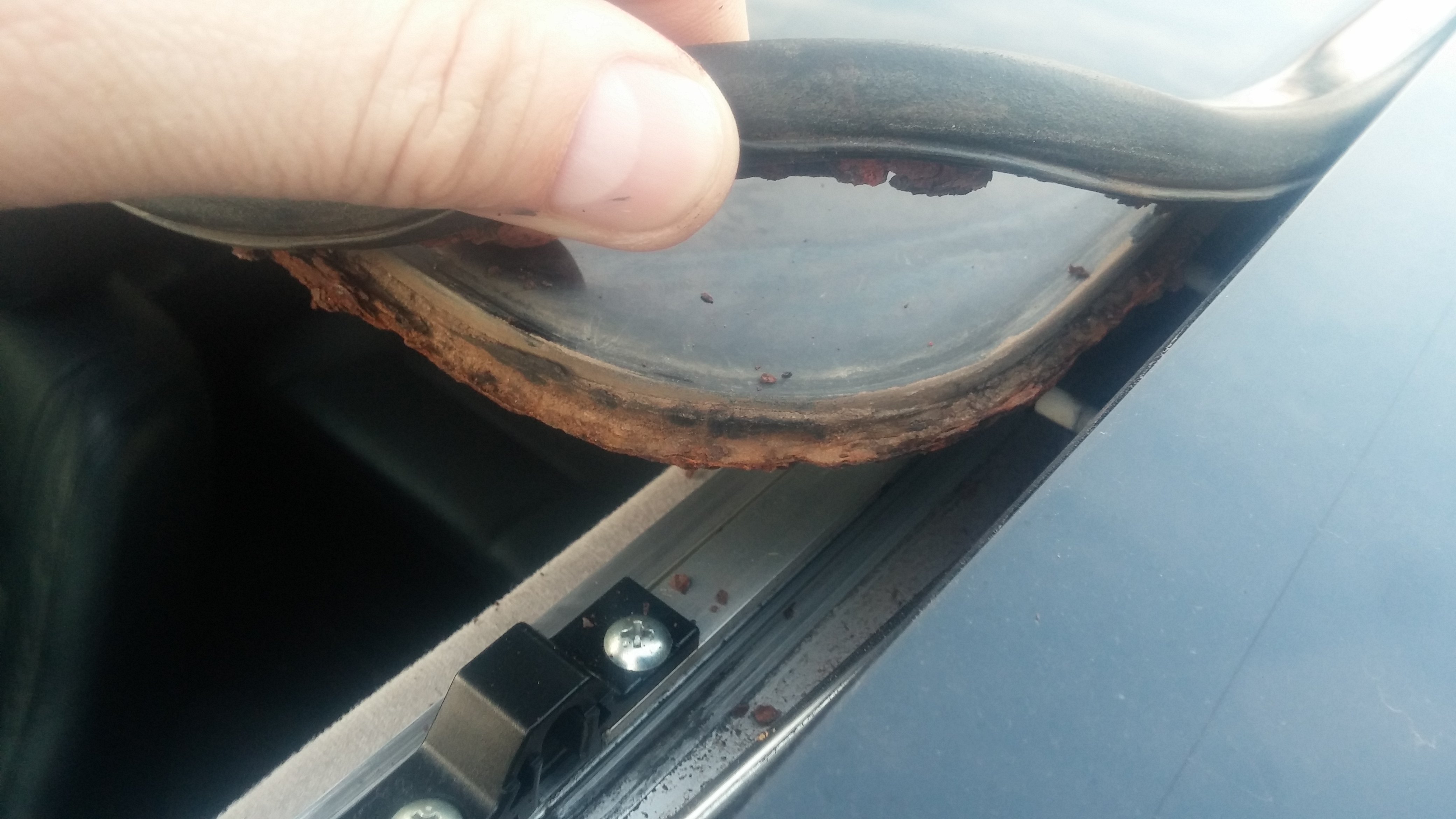

After reading about the Pajero sunroof rust problem I checked the sunroof on my 2011 low mileage Gen 4 SWB and found two smallish rust bubbles on the frame - nothing serious I thought. Luckily I had it checked at a good panel-beater. He removed the sunroof glass with its frame to do the fix. When removing the rubber seal that fits on the lip around the frame we discovered that most of the lip has started to rust. Luckily mostly surface rust and not too badly pitted at this stage. If this was left a little longer the damage would have been terminal. That panelbeater showed me that it is simply a flawed design. Rainwater or moisture gets trapped on the rim of the frame with nowhere to go.
It is very easy to remove the sunroof glass with its frame. You simply undo the 6 torx bolts that attach the frame to the carrier mechanism and then lift the glass with its frame out. Then it is easy to remove the sealing rubber to inspect, clean, repair and paint the lip of the frame.
My advice. Go and have a good look at your sunroof or even better, remove it to do a proper inspection
- even if you have a new Pajero. If discovered early it is an easy and inexpensive fix.
I attach of photo of the rust on my frame. This was not visible before removing the rubber seal. Apologies - the quality of the cellphone photo is not the best.
