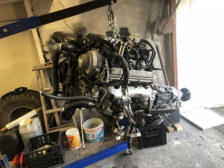

Now time for an update!!

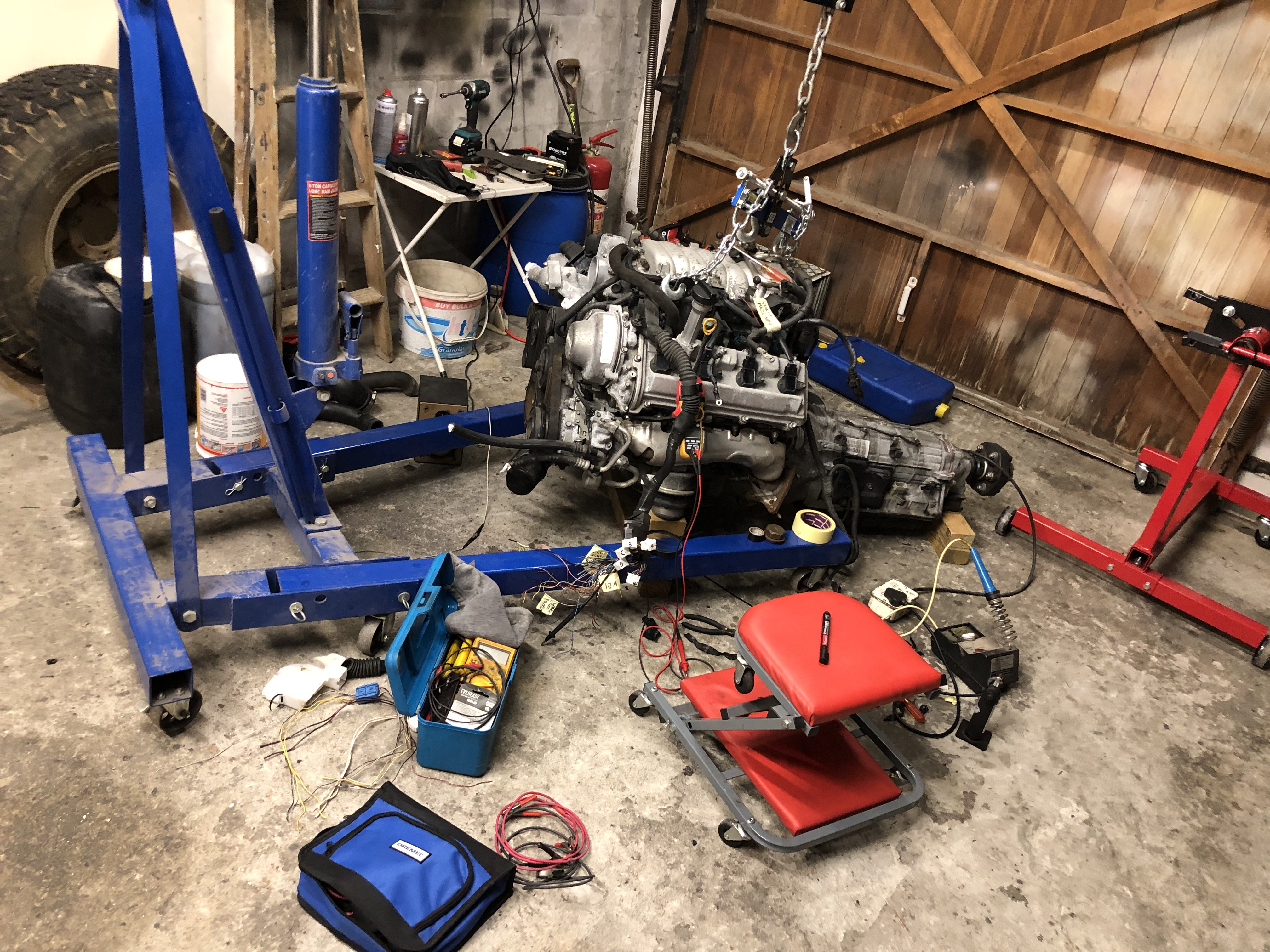

I am now the proud owner of a not so new yet new to me Lexus 3UZ with 5 speed box complete wiring loom and ecu and all the other accessories to.
Ya I am aware that the whole plan of checking it out and taking measurements also went flying out the window apparently, one because I got tired of everybody giving me excuses or just not even bothering in replying or calling back. So my DIY instincts kicked in and I found a good engine literally on the other side of the tracks, pretty much walking distance. I have heard a few people mention that the lexus bell housing will fit the pajero auto box just like that but there is a twist. The pajero's in question is the 6G74 multipoint injection with 4 speed auto boxes ( V4A51 ), they work as mentioned. I have only found one case of a guy doing a conversion with my type of pajero, myne is the LWB Pajero Exceed with the DOHC 6G74 direct injection with 5 speed auto box ( V5A51 ). As it turns out the lexus bell housing does not fit this box neither does the shaft swap work. Now my car is a japanese import and was never sold in south africa as far as I understand which explains why no one can find anything in any system about it or for parts, finding things for this engine is a task that will drive you mad hence my reason of abandoning the engine after all ready trying it once and failing. The japanese VIN and engine numbers don't help either neither do the ones they embossed so kindly at the police clearance station.Now I don't plan on using the gearbox but I will still be trying to see if it is true that the bell housing doesn't fit and if it doesn't well maybe it can be used along with the pajero bell housing and mated together to make an adapter but I will have to see.

So as it turns out I have actually scored quite a bit and bought a 3UZ with a 6 speed box which seems to be still running the factory spark plugs so less then 50000km on it and I payed the same price as a 5 speed. So in other words I saved R4000 on this one. Payed R21900 for mine by the way.

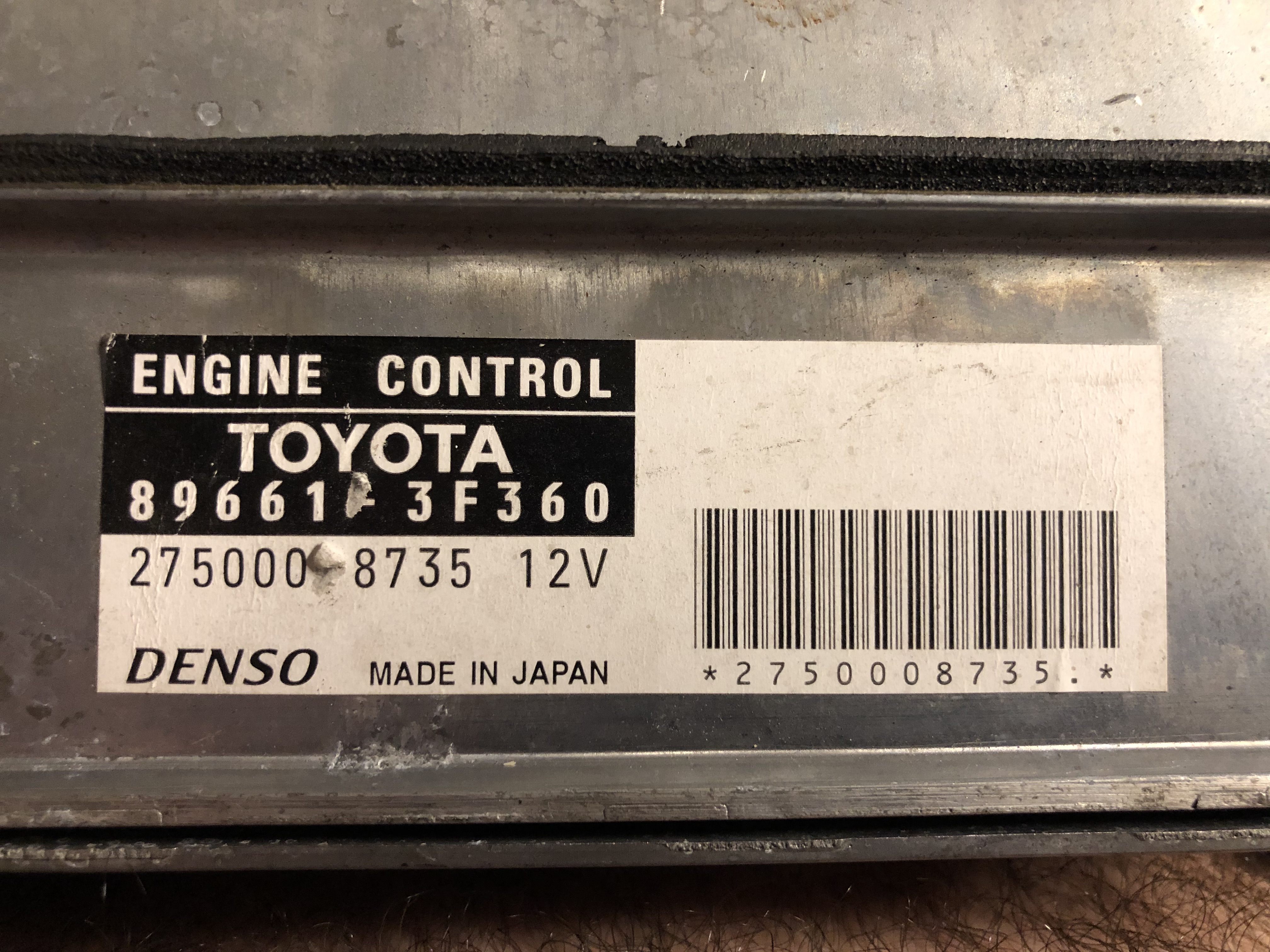

Apparently if the ECU has that 3f360 bit at the end then it is a 6 speed engine and box which is the newer slightly more powerfull version.
Now I still need to find a way of bypassing the standard ECU since the places I have contacted so far including the referral numbers I was given all don't seem very keen on doing business of any sort, like have I missed some sort of grand nation wide lottery and I am the only one that still needs to work for money? Now that being said it would appear that the 6 speed box ECU's are a little different then the 5 speed boxes since the " solder in a board and pre programed EEPROM " method doesn't work on them. Apparently the immobilizer needs to be turned off in the software. I am still researching the truth behind all this since what I have found so far is that you can buy the little board you need to solder in online along with the pre programmed EEPROM. Some say that the little board and EEPROM trick will work on the 6 speed as well, others say it will only work in software.

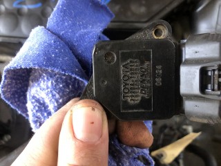

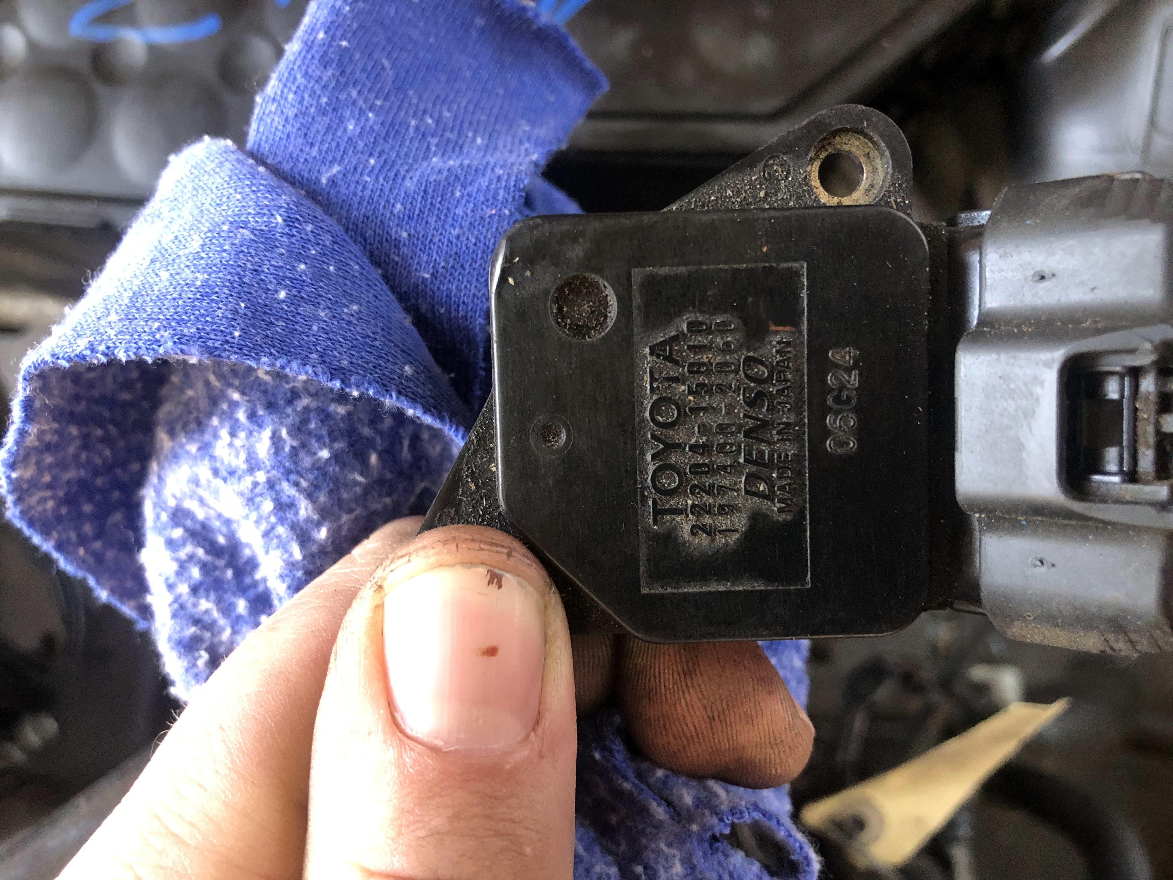

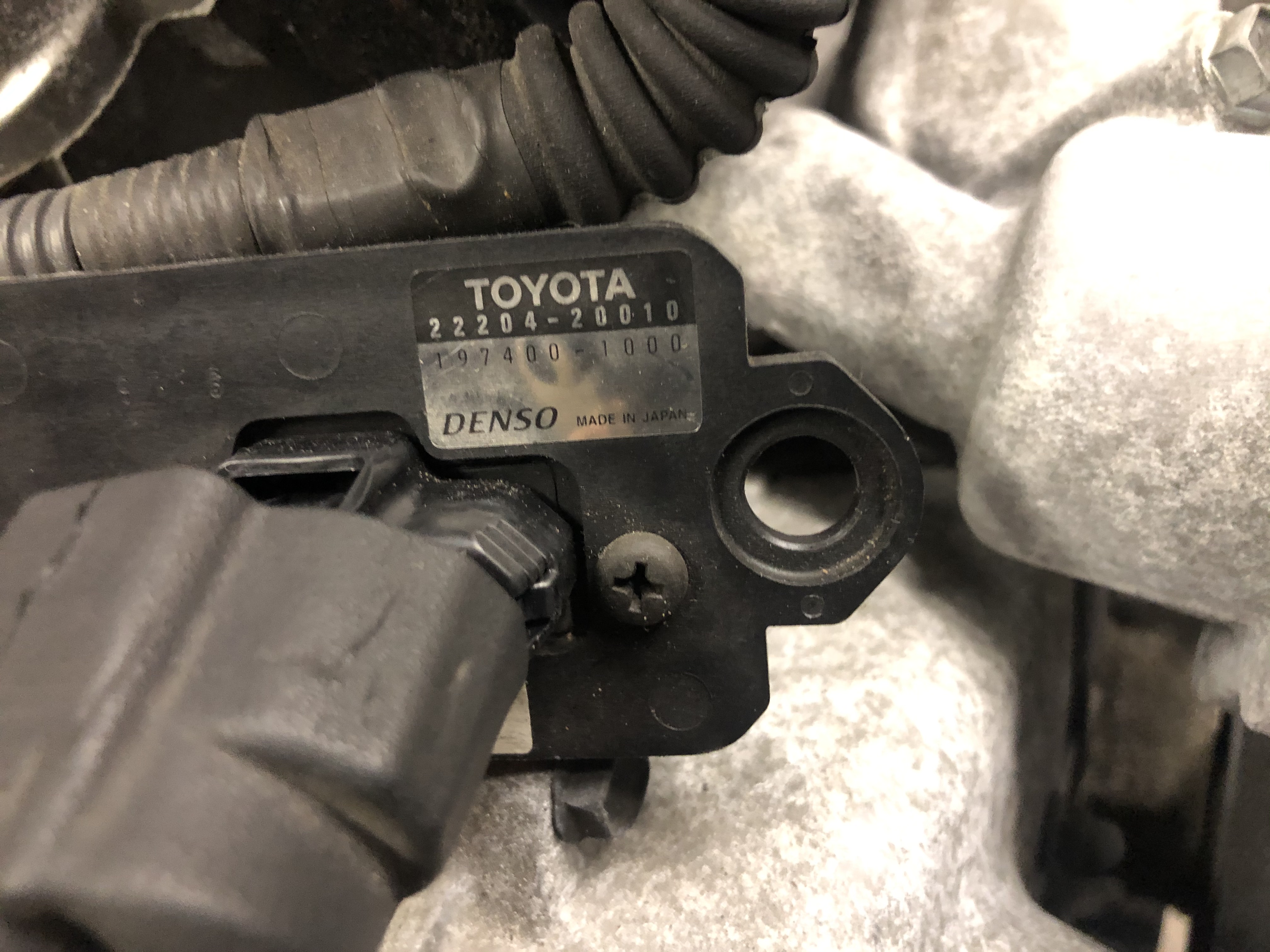

Other then that it appears I have the older MAF sensor instead of the newer cartridge type but on the schematic drawings they have the same pinout descriptions just on different pin numbers so in theory I can save myself the money and just rearrange the wires to make it work since the plug fits perfectly but will test this out as soon as I am ready to start this engine.
That is the part number for the older torpedo looking one.
That is the part number for the cartridge type one for the 6 speed engine, The 5 speed engine's MAF sensor part number is 2204 22010. Weirdly the 5 speed one is more expensive then the 6 speed one.

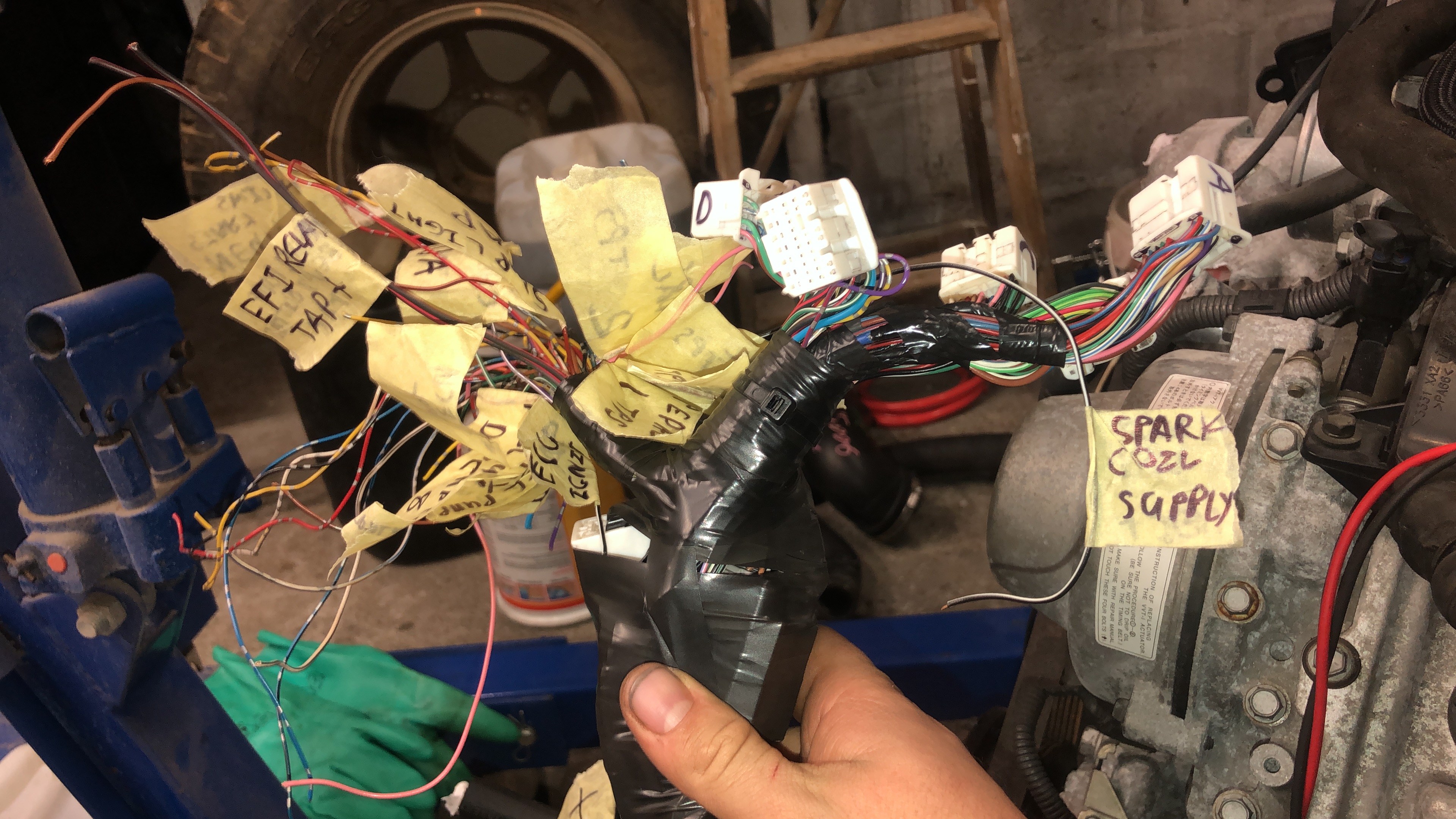

Still need to pin out the needed ECU wires for my build, I will try and upload all my ECU pinout wire numbers and wire colours as well as what go's where and what it is used for to make it easier for the next guy but no promises. I will post again when I am ready to fire this baby up or at least until I remember something I forgot to mention now.
