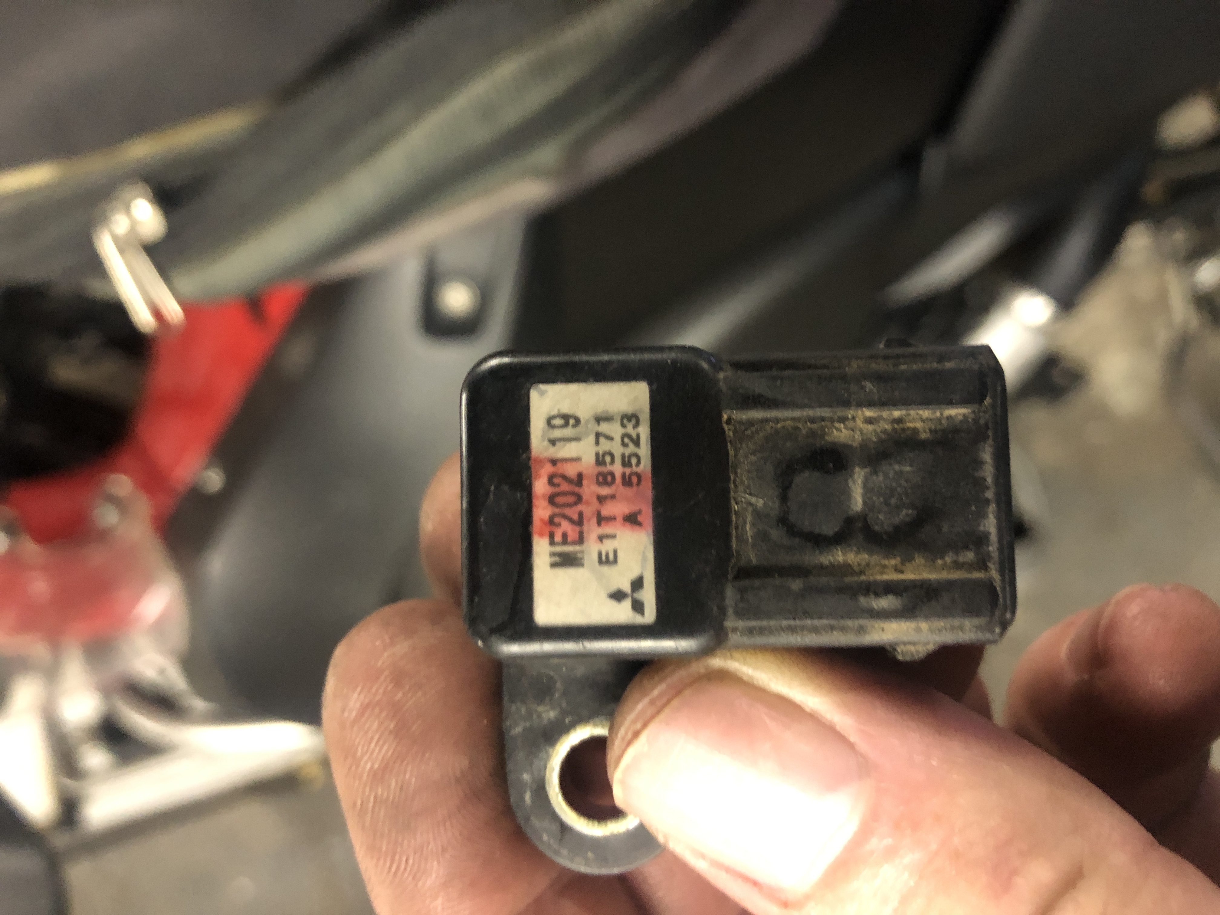

2006 3.2 DiD with 320000 km - engine light recently on and MAP sensor error code read by local AutoElec shop.

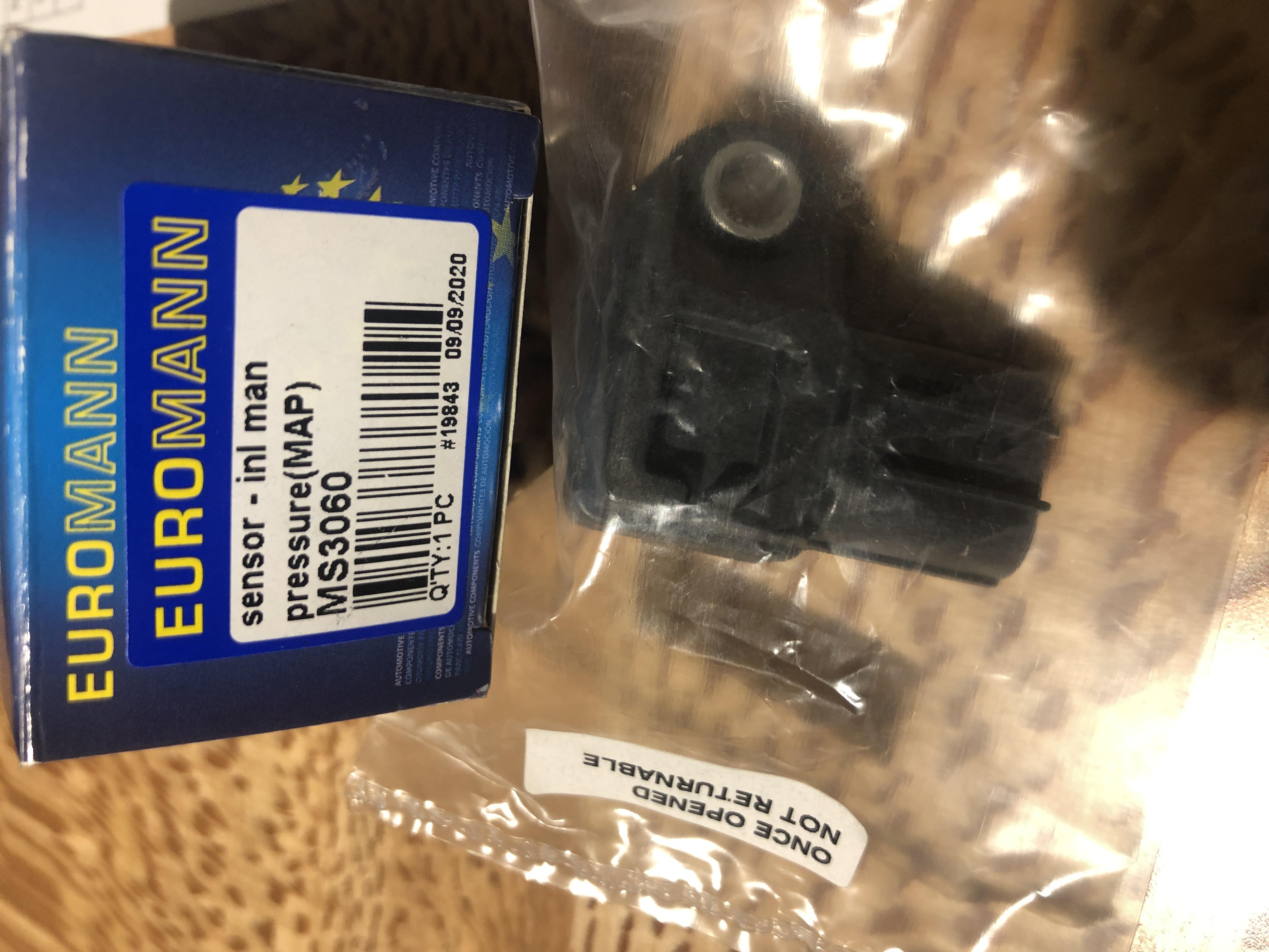

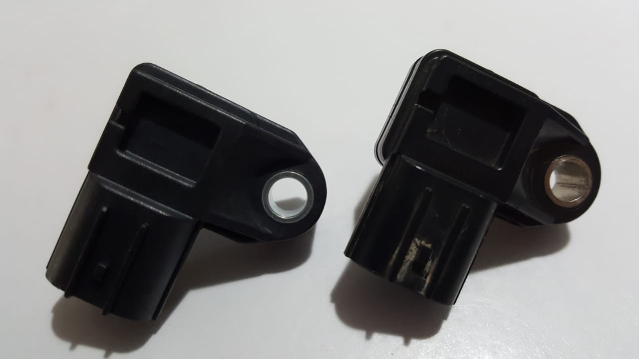

I bought the Euromann MAP sensor (part MS3060) from Masterparts and it appears to be identical to Dirty Dog's photos. However, it differs from my original sensor somewhat in that the "ear" is on the other side and the 3-wire plug is different. Layout and size is similar and pipe fitting down to inlet manifold the same diameter.
The original Mitsubishi part number is ME202119. Please see photo's of both parts.

The best bet is to go into MasterParts in the Strand, since you are near them, and exchange the sensor for the correct one if you haven't opened it yet. I am sure they will exchange it for you. However, once you open the plastic packet, your warranty is void.
I have never tried to modify them, as mine fitted perfectly as is. MasterParts has a vast inventory of Mitsu parts and sensors, just take your old one as an example. If you need to drive the vehicle there, it's an easy job to remove on site (or should be!).

I'm afraid Masterparts does not list a part for my 2006, nor could they track one down. I took the sample in. It would appear from them that the earlier ones are different and agents only.
HOWEVER, it wasn't the MAP sensor after all! While discussing the thing at my local Auto Elec, the eagle eyed young technician pointed to the boost pipe (from intercooler to throttle body) and said it had a crack in it. Upon manipulating the pipe, it was a great big hole venting all that lovely boost to the atmosphere and confusing the poor MAP sensor, which then understandably declared an error. I saw the same thing on an Aussie YouTube video and should probably have checked.
New (agents) boost pipe is R4000 and 5 weeks ex-Japan, BUT the hole was about 25mm from the end, and there is a little play. We were able to cut the pipe off square and re-fit the hose. All error codes gone and it pulls like a train again. I did 1700km with it last weekend without any issues at all.
