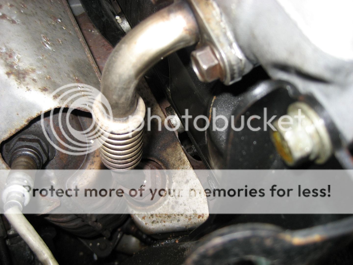

Re: Pipe connecting injection and manifold
south africans are not bound by the strict emissions standards, so if your warranty doesn't get voided then i would recommend blanking it off.
I merely just took off the pipe and had it cut and crimped and put it back on - i don't know if this will create an error with your ecu though.
before
after
Brink_015
Thank you for the illustrations and help.
Will do the modifications.
