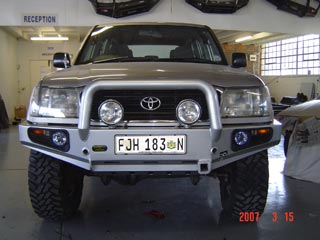

4x4 Outthere wrote:
Now for the cost: All the steel, Laser cutting, pipes, bending and Powder coating .....Hold your Breath...............R2278.00.
Hell. This is absolutely awesome and even more so fir that price. It is incredible how much one can save besides that special feeling of "oh yes, it looks good and I did it"
I have just finished three heavy duty cross bars (still to be powder coated) which cost me a few hundred bucks whereas the specialist wanted around R2K each
Your wheels overally looks really great, congrats!

Not to be rude but drawings will be excelent. Your's wont fit mine (Pajero IO) but I can surely use the design. What spot lights did you use? I enquired about spots a while back as shown underneath at Burnco and the guys said only the spots is +-R4000. You mentioned that its a three piece bumper with your center piece (winch part) being your base but I still see some welding holding it together. Can you maybe take some more pictures with a explanation?

Fielies the the welding you see is to hold the side bumper to the upright. In otherwords the upright and side bumper is one unit. Winch base the next, and that will bolt on to the two sides once they are fitted and then your oppisite upright and bumper a unit. I have tried now to upload the drawings, but it is not going.
The Spots on the roof and the spots on the bumper I bought in Tanzania. I travel up to Tanzania atleast four times a year and I bought it there. I will try again tonight and see if I can download the drawings
A photo of the Bumper I have build for my 2.8.
