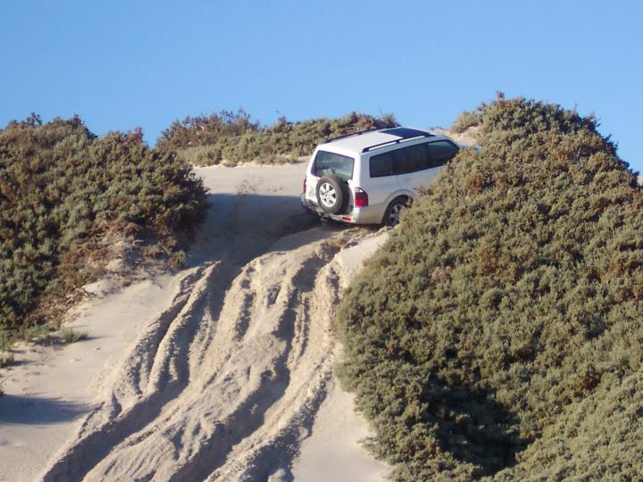

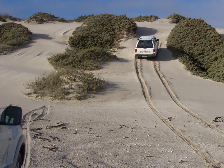

How does one post a pic. I was involved in a little competition a few years ago with a gent in a 4x4(top of the range - best in the world - always goes right) bakkie and had NO problem storming a dune (up and over), while he battled to get half-way up. I have the pics to tell the story!

Gerhard,
I get the impression you are keen to see the pics.
