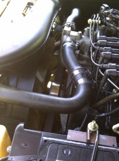

Inline coolant fitting installed in top radiator hose

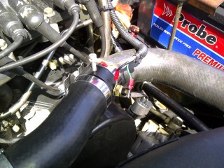

Coolant temp probe & coolant presence probe.
I cut the top radiator hose and fitted an inline plastic fitting that accepts the coolant temperature sender and coolant presence probe.

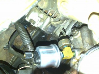

I then removed the oil pressure switch (note this switch does not give pressure readings, it merely switches off the idiot oil light on the dash when a prescribed oil pressure is achieved - at approx 30kPa in the 3.5 v6 very low!). I then fitted a brass 1/8" tee to allow me to fit a 10bar VDO pressure sender unit as well as the OEM pressure switch.
Oil pressure switch removed and inline 'T' with pressure sender and switch fitted.

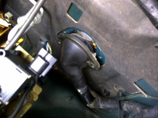

I then pulled the wire loom through from the dash and through a rubber boot in the firewall on the passenger side, and connected to all the sender units. I was sure to ground the unit on the block of the engine to ensure accurate readings, as even small voltage differences between engine block and chassis will give inaccurate readings as the sensors work on low voltage.
Rubber boot loom access through the firewall.

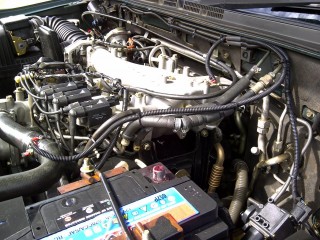

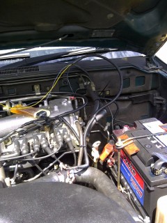

Wiring the engine
Wiring the engine
Engine wiring finished
