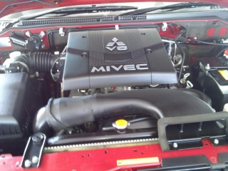

My Indi (and I trust him with my car :D ) refuses to do more than just wipe the engine clean. He will not use a spay gun or a hose. He believes the companents in the engine bay were not designed to be exposed to direct water spray.
The dealer that sold me this one obviously didn't agree with my Indi :twisted:
Prepsol? I'll have a look-see in our few shops in town. I'm sure a little care when applying the spray gun will be enough to preserve the "softer" components in the engine bay.

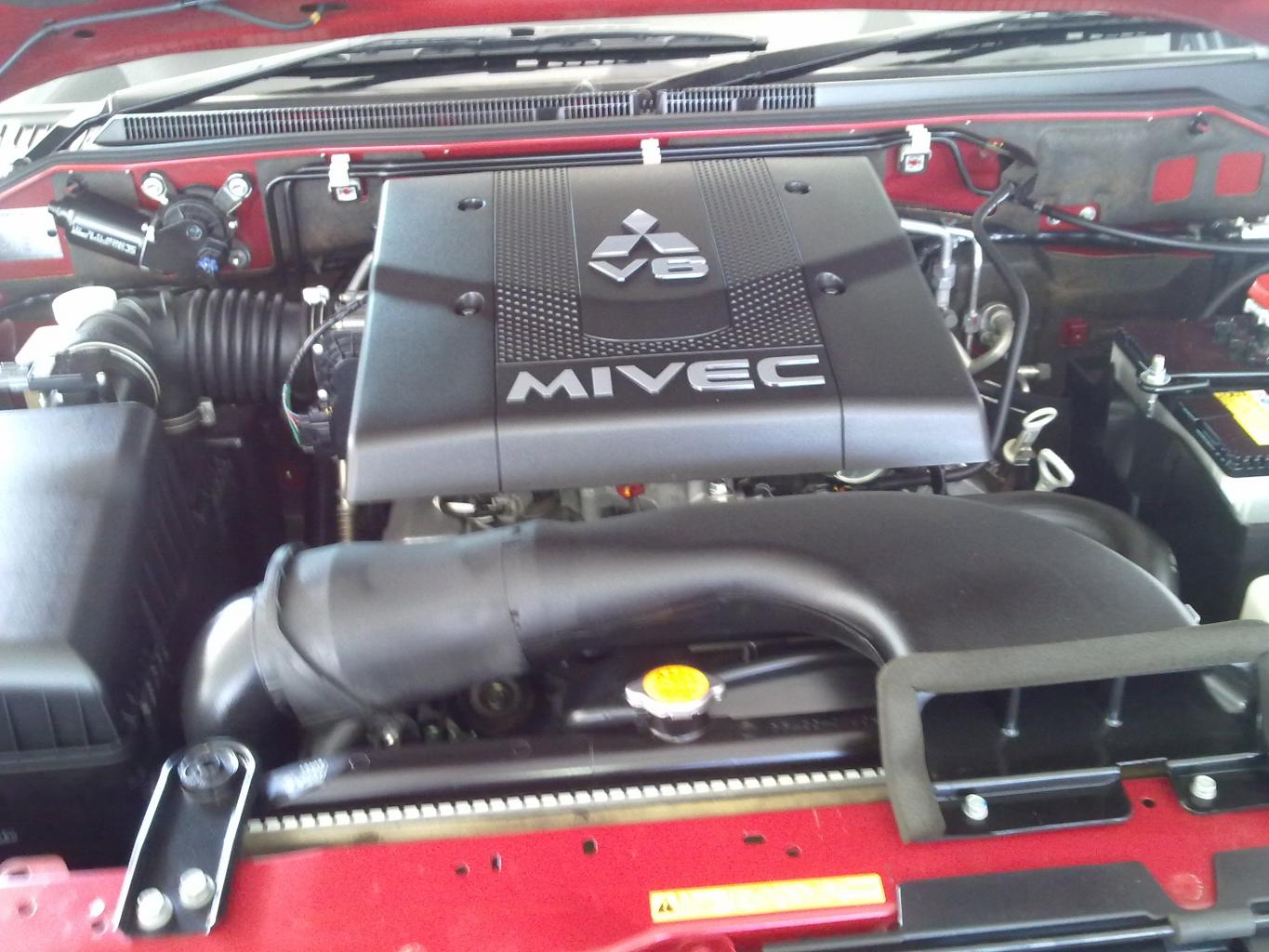

my engine (My previous Pajero - Gen2 3.0 V6) nearly at the end of the rebuild. Joh! What nostalgic drugs are running through my veins now!
https://www.4x4community.co.za/forum/sh ... 181&page=1
and after it was born again
and 4ePajero's engine just after his transplant in his Gen1
