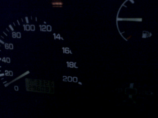

This is my fuel status at the moment
332km
Sent via iPad & Forum Runner
332km
It does however include a half days off road play so maybe it has made a small difference. My fuelly will tell over time.
