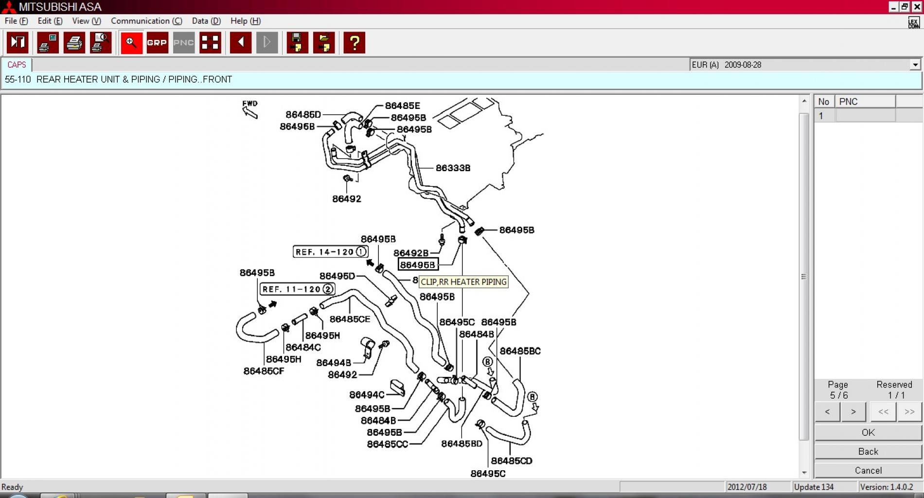

the heater t pieces are on the bottom right near oil filter and do become brittle with age and the heat from the rear aircon.
