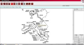

I only purchased the gasket as this was done last year already when i was going to do this. Other wise only carb cleaner and lock tite
No other purchases needed.
the heater t pieces are on the bottom right near oil filter and do become brittle with age and the heat from the rear aircon.
t pieces
t pieces
